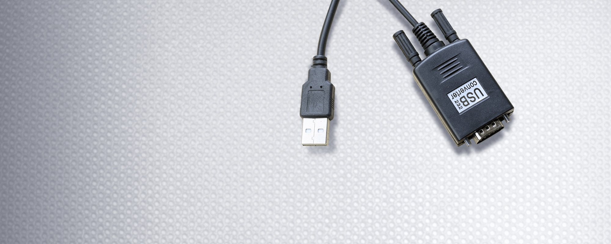

Plug it into your computer. You may need to install this driver:
It should mount to your computer as a virtual COM or Serial Port. Once it does run the script documented here:
