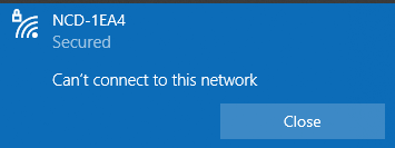

I then pressed the CFG button to put it in configuration mode, clicked on NCD-1EA4, entered NCDBeast, and received this message:
After doing some testing I feel that, even though the Python script completed, the SPIFFS might not have flashed correctly. If the password is stored in SPIFFS, a bad flash could cause the AP to reject even the correct password.
Of course it could also be caused user-error, on my end, if the USB-to-serial communication was unstable, then the firmware might have flashed incompletely.
Since I cannot access the Configuration Interface, is there a way to run.bat the SPIFFS file only?
Hi Alex,
I don’t think it would be feasible for the firmware flash to succeed but the SPIFFS flash to fail. Also If you never changed the AP password then even if the SPIFFS flash failed I think it would still accept the NCDBeast password.
If the device goes into Configuration mode when you press the CFG button(LED flashes blue and it appears as a WiFi network) then it sounds like the SPIFFS file is on the device.
Have you tried forgetting the WiFi network on your computer or tried connecting with a different computer, phone, or tablet?
I think the best solution at this point may be to have you return the device and I can update the firmware for you. I don’t want you to struggle any more than you already have, especially when I know the issue is now resolved with the bug fix.
