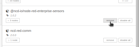

  1. Uninstall Libraries:
  • Uninstall the @ncd-io/node-red-enterprise-sensors and ncd-red-comm libraries. You can do this either from the Node-RED editor or via npm:
    cd .node-red
    npm uninstall @ncd-io/node-red-enterprise-sensors
    Note: it is probably you get an error during uninstall β€œncd-red-comm” it is okay.

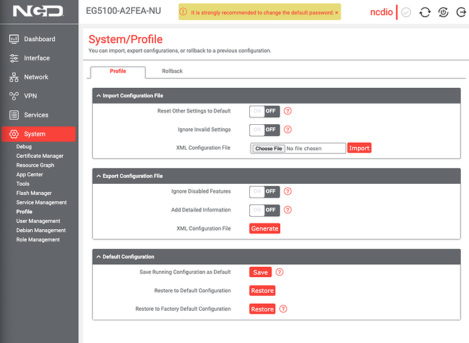

Or you can back up your flows using node-red’s export and do a factory reset via the web configuration UI > System > Profile > Default Configuration Section > Restore to Factory Default Configuration.

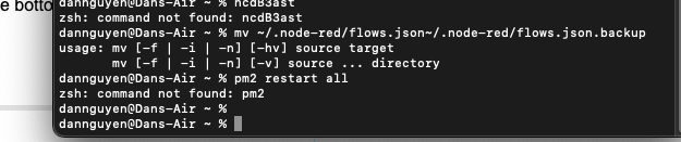

thanks, I followed these instructions to enable ssh.
What command do I need to run to get into the I tried
ssh ncdio@192.168.0.1
the then it doesn’t run those commandas
Ok, so I followed the commands and was able to reset it…
