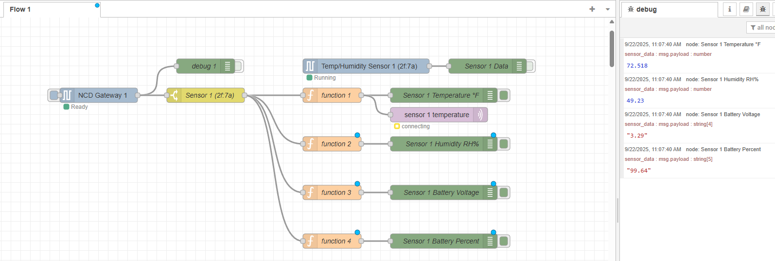

So purchased the gateway lite (sku: NCD-Edge-CR-Lite) and a temp/humidity sensor (PR52-33A). I have the sensor data parsed down to what I want to see.

A simple TCP connection can be used by setting up a TCP driver in the OPCUA Config under Device Connections in the Ignition Gateway. Setup the driver in the Ignition Gateway with the IP of the NCD gateway and pick a port, then setup the TCP out node in Node Red to listen on that same port number.
