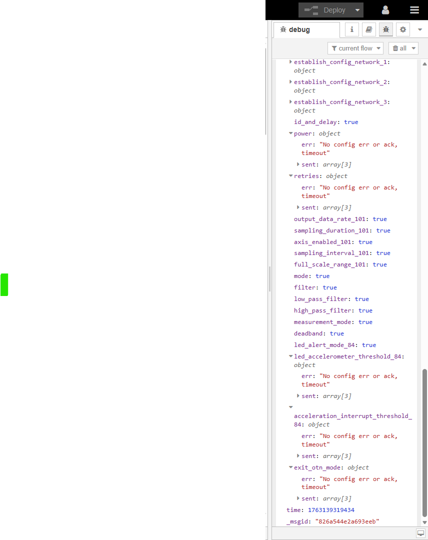

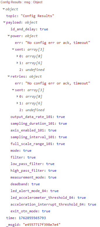

I have tried several times to reprogram some V3 tubular vibration sensor remotely (Over The Air).
3-Axis Vibration Sensor - Wireless Vibration Sensor
Each time I try, I get the message “No config err or ack, timeout” for ‘Power’ and “Retries” in Node-Red. The other variables are OK.
What is causing these error messages? Is it possible that these sensor have been successfully reprogrammed despite these error messages?

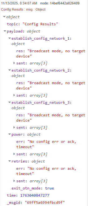

Hi @bertrand.gauvreau Please enable the ‘Wait For Network Formation’ checkbox. Then, disable all other already configured parameters and only leave the Power and Retries checkboxes enabled.
After making these adjustments, please try the configuration procedure again and share your results.
Eduardo M
I tried it and got the same error messages.
Hi @bertrand.gauvreau Apologies for the misunderstanding, this device does not support OTA, you can ignore the error messages, power and resets are set to maximum by default

Hi @bertrand.gauvreau Sometimes the sensor doesn’t respond to the settings quickly enough, causing the Node-RED configuration process to time out. This is likely the reason you are encountering an error. Could you please try the sensor configuration process again a couple of times?

Hi @Eduardo_Mtz. I tried the sensor configuration process many times and I always get the same result.

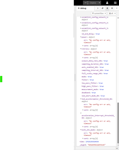

Hi @Bhaskar.
I get this with the settings you suggest :
Thank you
Not sure why it wont respond. the default power and retires are set to max.

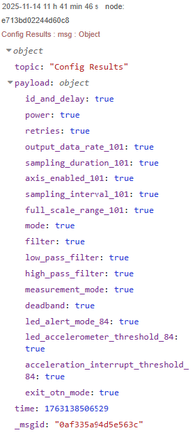

Is there an effective way to check the “Power” and ‘Retries’ values stored in the sensor once these values have been modified? Unfortunately, the values returned in “Config Results” do not include Power or Retries.

can you try putting in it manual cfg mode
The sensors are installed in one of our customers’ factories located more than 150 miles away from our office. That’s why I’m trying to reconfigure the sensors remotely (OTA). Is there a way to read Power and Retries other than the Node-Red node in OTA, since the Node-Red node seems to be unable to do so for several of the sensors?

I ran tests with seven V3 tubular vibration sensors, type 84.
Five of these sensors use firmware versions lower than 23 (17, 20). All of these sensors returned error messages during configuration.
Two of these sensors use firmware version 23 and 24. They did not send any configuration error messages.
Therefore, based on my observations, the error message during configuration seems to be related to the firmware version.
Now the key question is: are these messages generated because of a bug in the node-red-wireless node, because the parameters are simply not saved in the sensor, or because the sensor sends an error message even though the data has been saved correctly?
