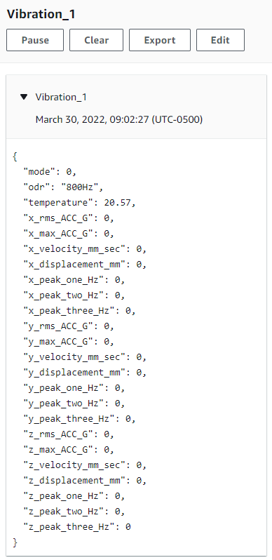

one time it was sending data but the data table is kind of weired
So the middle node is Current, bottom one is vibration. I followed the steps in the video, but the vibration sensor is not gonna be completed.
And even I can see the “Running” sign on the current node, the data is not comming up. I set the delay time for current to 30, and vibration for 0.

vibration sensor will send zero data if
  1. sensor is not installed on a running vibrating machine
  2. if the vibration value is below 0.035g.
Oh then the current sensor is the same reason why it doesn’t work?
Thank you, but it stopped sending data(not even zero) after one data came out. If it is connected to a running machine, it will send data constantly?
