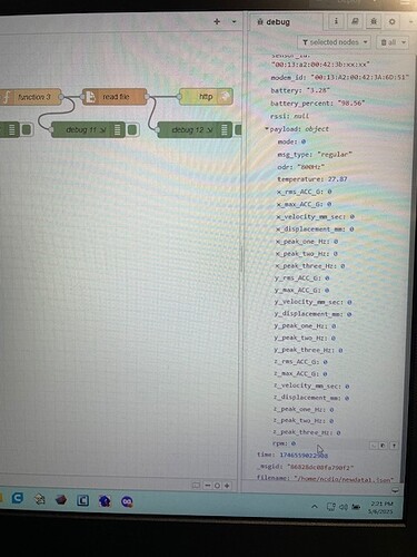

The new sensor appears to be sending packets, but the packets with the exception of temperature, continue to have “0” for all of the values.
To make sure we are on the same page, i am resetting the unit by running the magnet across the top edge of the sensor which causes the white LEDs to flash a couple of times.
Bhaskar,
FYI, I have a debug node setup at the sensor to see if any data is being transmitted. No value is being transmitted. Furthermore, no low or high band filters have been set on Active. Pease advise. Thanks.

Bhaskar,
We had the unit installed on a running electric. motor to see if we can capture any data to compare it with our other vibration instruments.
f the motor is running while the sensor is sampling, there’s absolutely no reason it shouldn’t capture vibration. The payload doesn’t indicate any errors either.
Also, the sensor was shipped in Mode 3 (Smart Mode)—did you change this setting?

Bhaskar,
I agree, we should be seeing data but we are not:
  • we did not change the smart setting.
  • rpm was enabled (not sure why you are seeing disabled).
  • Will activate the deadband and set value to zero. FYI, we had tried that before, but will do it again.
  • Also if you’ve noticed there is no RSSI value.
I will let you know if anything changes.
