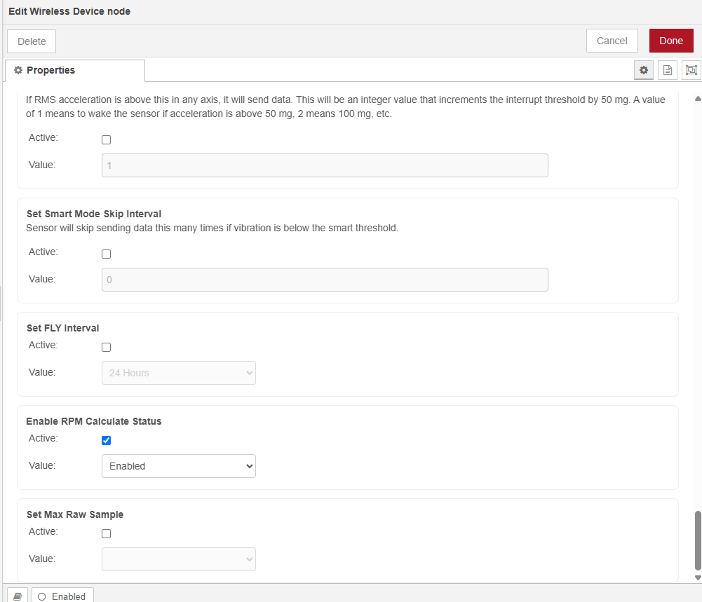

if you want to get data fast –
  1. set interval to 1 min
  2. set smart skip value to 0
  3. set smart threshold to 1
This will make sure sensor sends data every min but it WILL drain the battery faster.

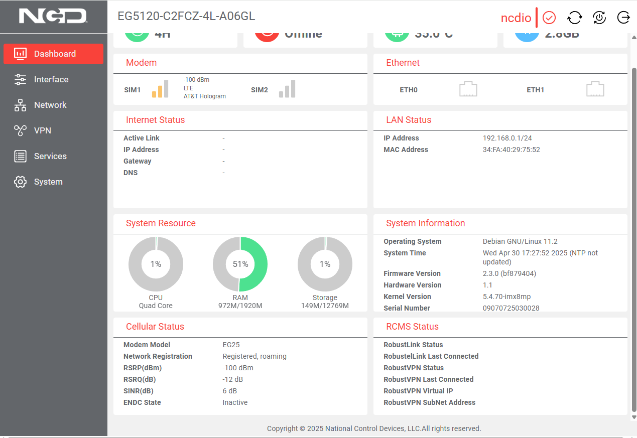

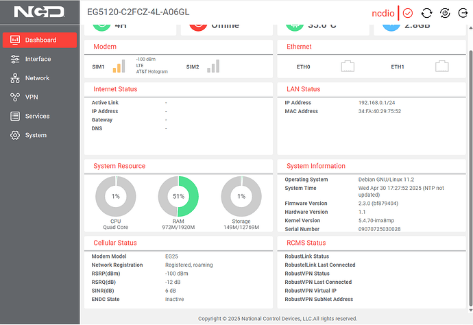

We are trying to send the sensor data via NCD Edge 7552 gateway using cellular service. We have setup the cellular service using Hologram and have set the APN to “Hologram” as per the instruction of the vendor. The sim card is active, the gateway has cell service and signal, however, we are unable to remotely access the gateway. We are using browser and the gateway’s IP address to access the unit without any success. Please advise if there are any other settings that we need to setup in the modem to interface with the cell service. Thank you.
the gateway continues to initialize and drops cell service?/

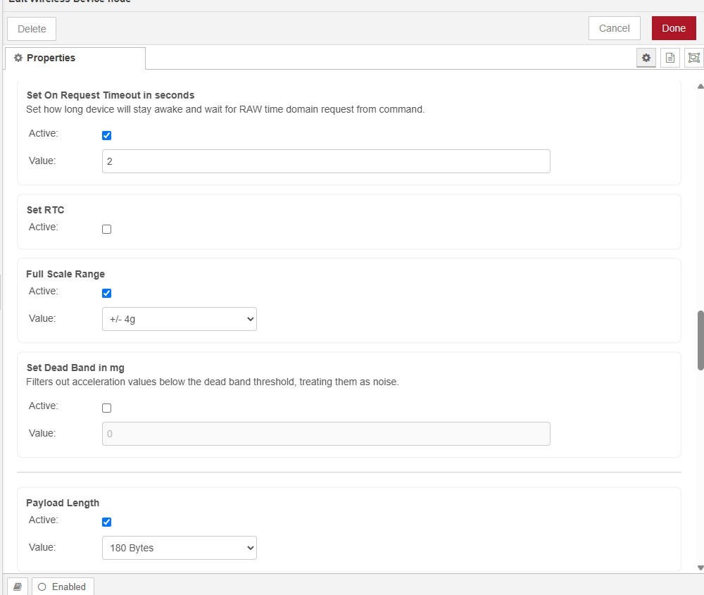

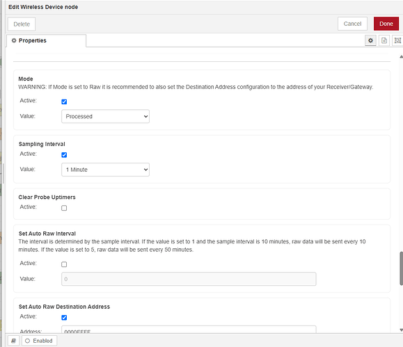

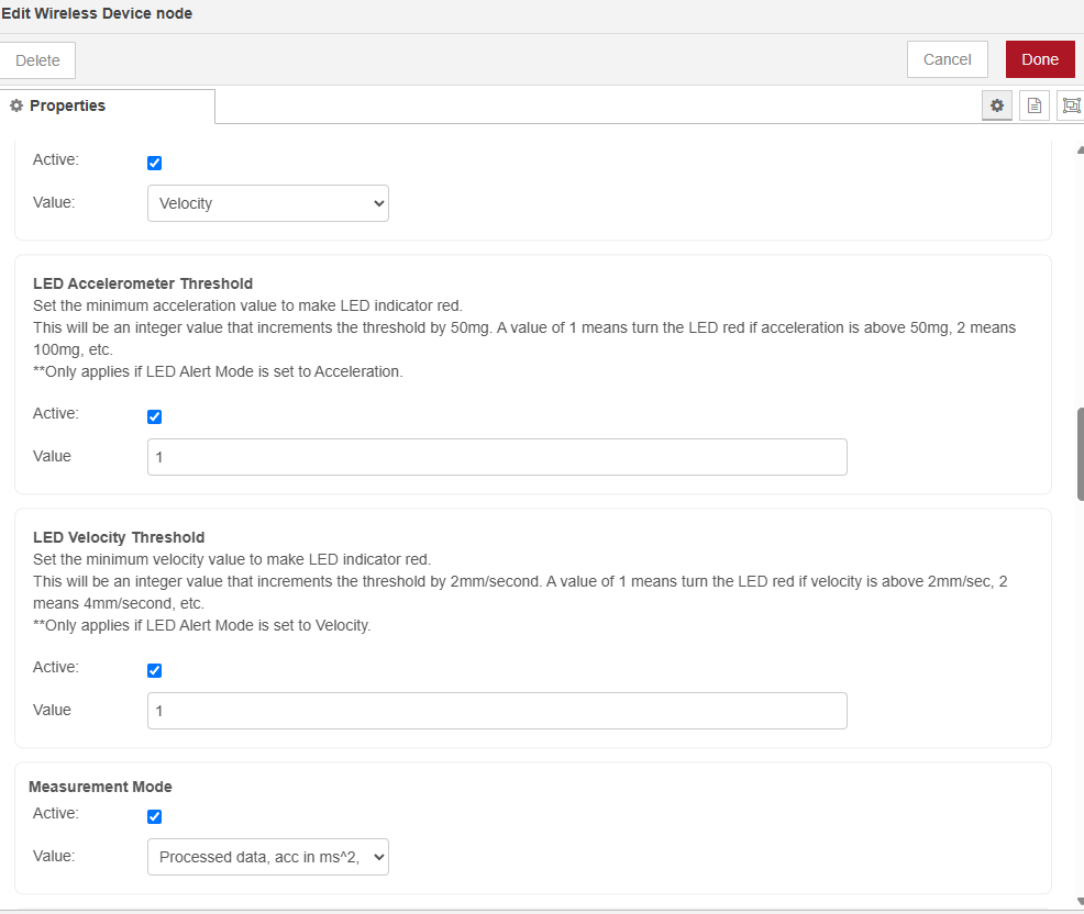

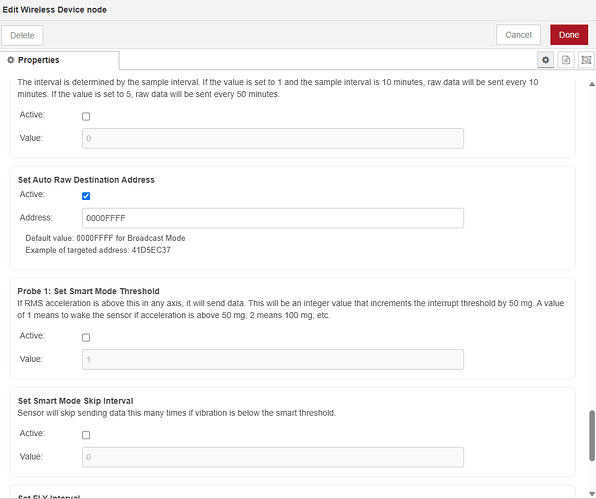

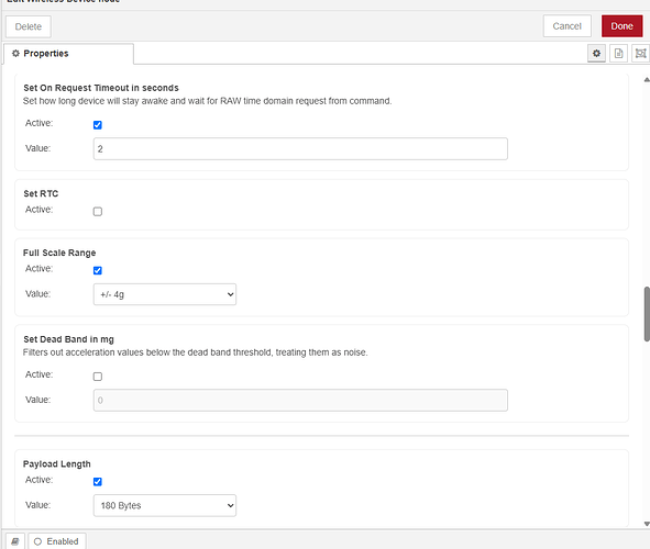

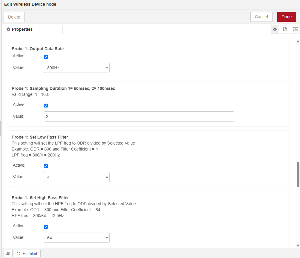

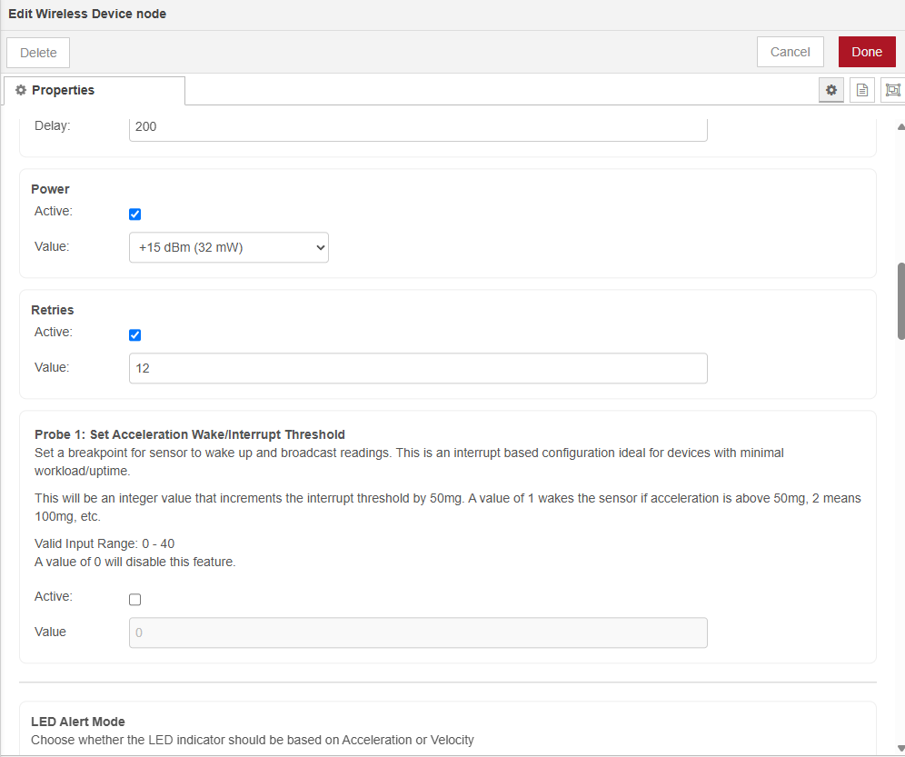

We continue to have issues with the sensor dropping off often. FYI, attached are screen shots of the settings. Please advise what can be done to keep this from occurring. We cannot
have this occur in the field. Thank you.

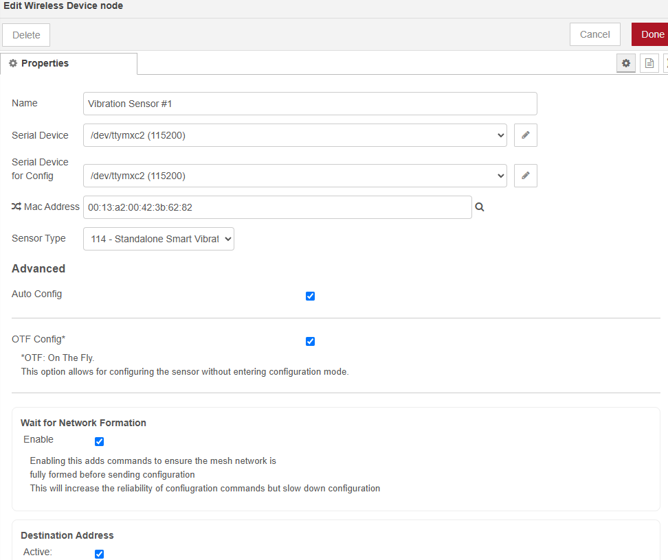

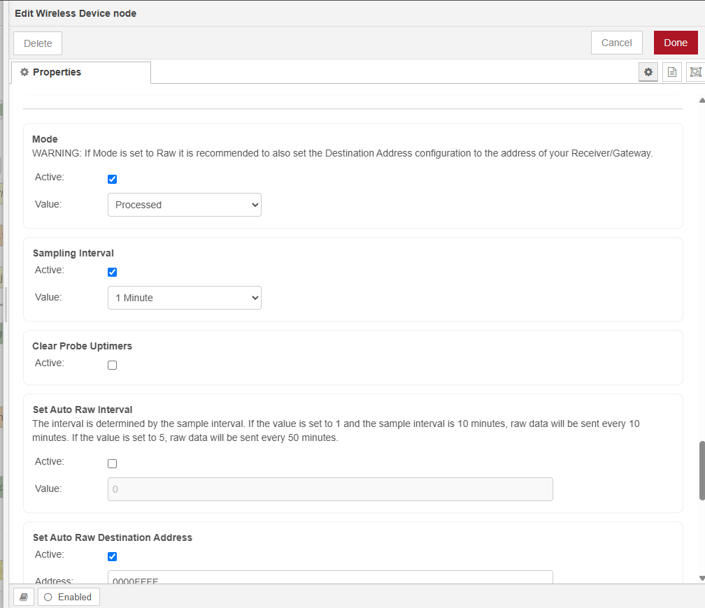

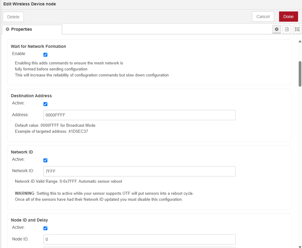

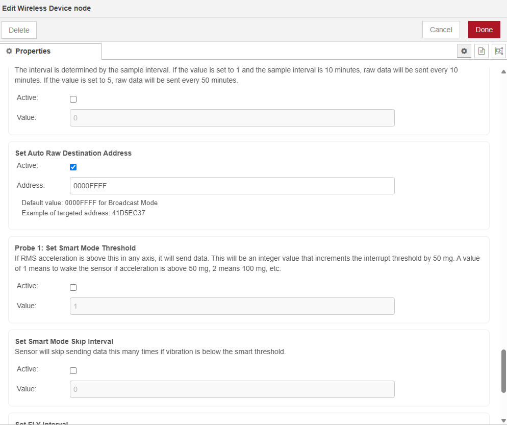

Hi @northstar Thank you for the information. In order to try to solve the range issue, could you please make the following changes:
  1. Uncheck the Destination Address property (by default, it is already set to 0000FFFF).
  2. Uncheck the Network ID property (by default, it is already set to 7FFF). Keeping this enabled will put the sensors into a reboot cycle.
  3. Uncheck the Node ID and Delay properties. For sensor type 114, you must use the Sampling Interval property instead of Delay.
  4. Set +24 dBm (250 mW) for the Power setting — this is the maximum value for wireless transmission power. Let me ask: is there any reason you’re currently setting it to +15 dB?
  5. Uncheck Payload Length (by default, it is already set to 180 Bytes).
  6. Uncheck the Auto Raw Destination Address property (by default, it is already set to 0000FFFF).
After making these settings, click the Done button and then Deploy. Next, reset the sensor to apply the new settings. (Be sure the sensor is close to the gateway to ensure successful configuration.)

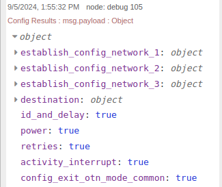

Could you also expand and share the 'config_results' message? This message comes from the Wireless Device node at the end of the configuration process. (I’ve attached a screenshot as reference/example. your own should be a bit different)
This is just to confirm the sensor configurations.
Please could you try this and let us know the results.

Looks like we have fixed the cell issue. How can we test to see if the cellular
feature works?

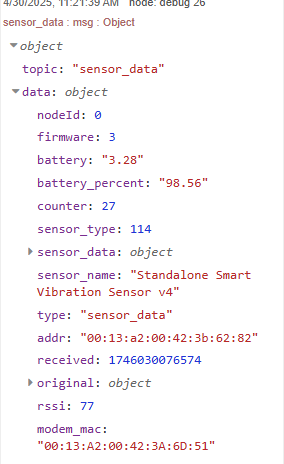

Hi @northstar a value of 77 in the rssi property indicates poor wireless signal quality.
Just to confirm, were you able to receive the Config Results message at the end of the configuration process, and did it show power: true?

Eduardo,
I did not get any Config Result messages. The material between the sensor and modem is just wood structure walls, with sheet rock and insulation. Nothing exotic.
