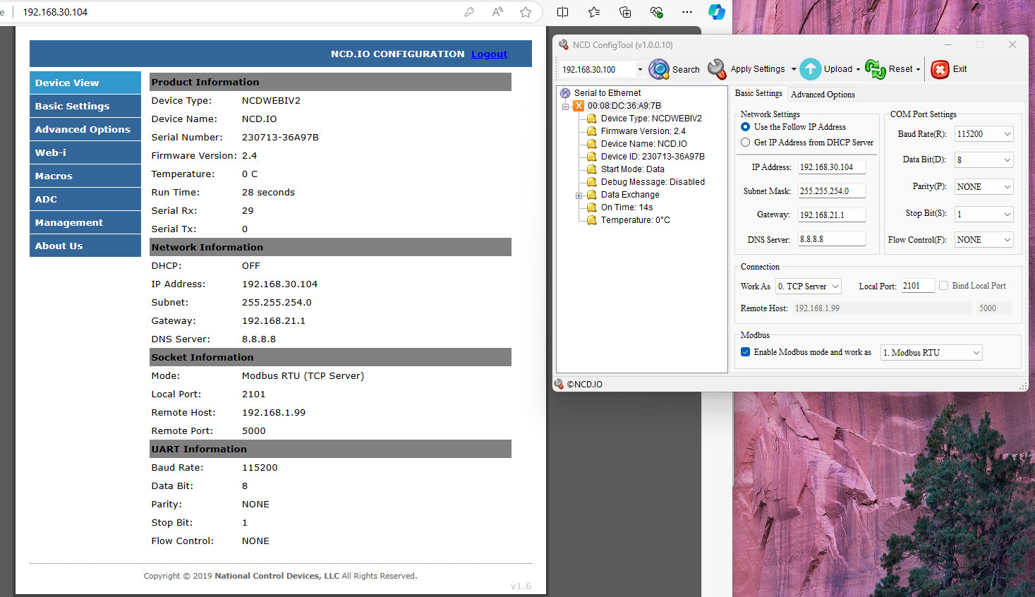

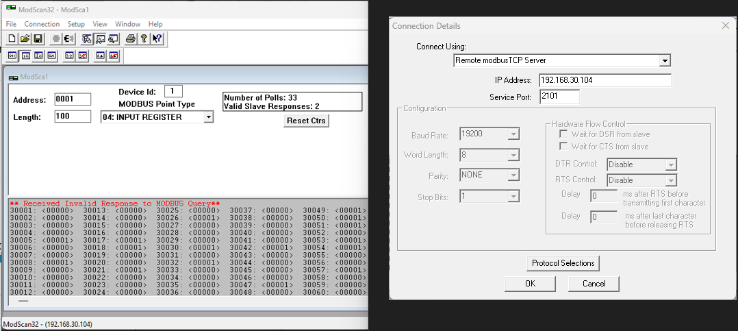

I have a Wireless Ethernet Modem PR55-17B that we are trying to use in Modbus server mode. Unfortunately, I have not been successful in connecting to the Modbus server and receiving any data. I’m using ModScan32 to view the data from the Modbus server, but the response from the Modbus server is invalid.
