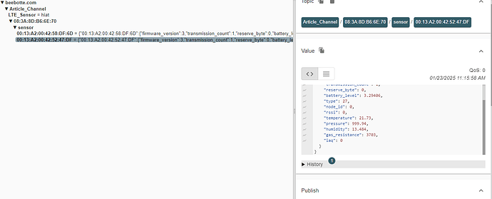

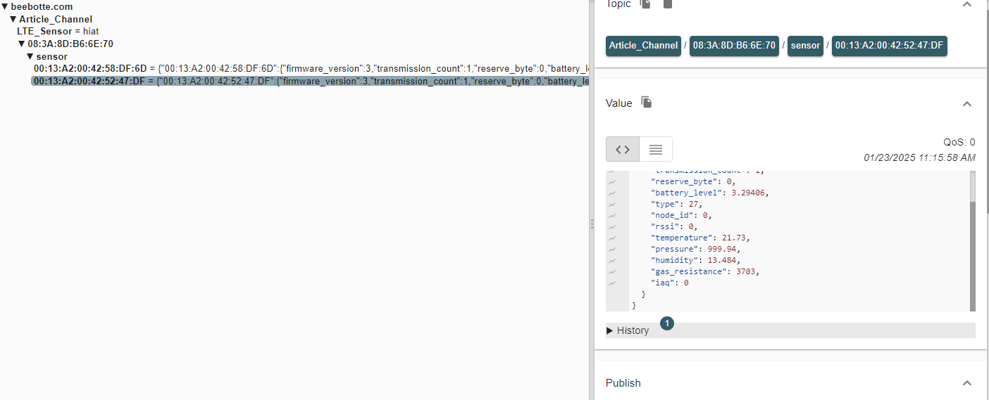

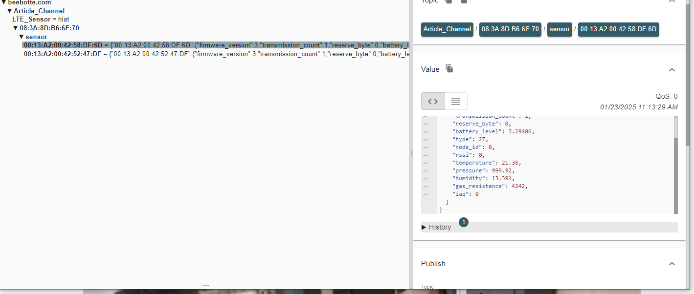

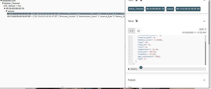

Sensor 1:
{macaddress:{"firmware_version":3,"transmission_count":158,"reserve_byte":0,"battery_level":3.29406,"type":27,"node_id":2,"rssi":25,"temperature":4.39,"pressure":952.58,"humidity":51.6,"gas_resistance":1.297691e7,"iaq":21}}
sensor 2:
{macaddress:{"firmware_version":3,"transmission_count":170,"reserve_byte":0,"battery_level":3.29406,"type":27,"node_id":0,"rssi":100,"temperature":35.22,"pressure":951.54,"humidity":6.984,"gas_resistance":1.297691e7,"iaq":21}}
Can you please help me determine why the iaq and gas resistance measurements are not working? Thank you.
