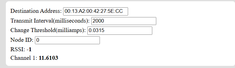

The issue occurs if i only have one of the devices connected to power. If both are connected to power i can go to the Web-Interface. But i wonder that the RSSI shows “-1” even tho the LED flashes green and indicates that the are bot connected.
Is there any way you can share a screen shot of what you are seeing for RSSI? -1 should not be a valid value.
but the transmission seems to work fine. Is there a minimum to the transmission intervall? I would like to update all 10ms. In the moment in the PLC the value changes permanently in a minimal ammount, is that just the noise of the analog signal or does Transmit interval doesnt mean the frequency of the signal exchange?
I would not recommend setting the Transmit Threshold lower than about 100 milliseconds.
