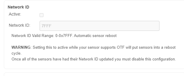

also setting network id will do it as well ( if you are setting it using node red)

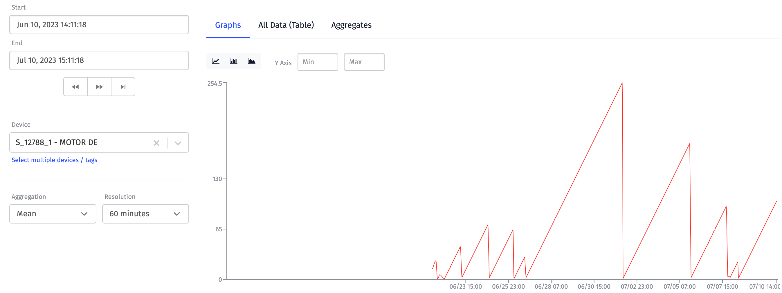

OTF is on but network ID configuration is turned off. We have Set On Request Timeout on, Sampling Interval on, ODR on, and Dead Band in mg on. I attached a graph of the frequency.
