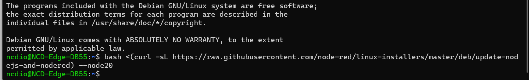

I tried following the ‘Update Node.js and Node-Red on the Enterprise Gateways’ blog but the ‘bash <(curl -sL https://raw.githubusercontent.com/node-red/linux-installers/master/deb/update-nodejs-and-nodered) --node20’ command did not seem to do anything when I was connected to the Gateway via SSH. Any assistance would be fantastic Thank you!
Hi @andrewpcc Could you provide a screenshot of the message you receive when executing the command? Also, is your Enterprise IIoT Gateway connected to the internet? Ensuring a stable internet connection is crucial for the command to execute properly.

Hi Eduardo, I have attached the image below. The Gateway should be connected to the internet as it is connected through ethernet to our network.
The gateway doesnt seem to respond to the command.

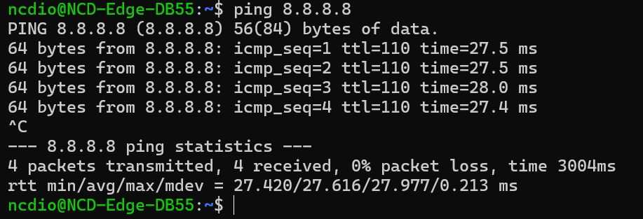

Hi @andrewpcc I’ve tried to replicate the issue, and it seems that the Enterprise IIoT Gateway is not connected to the internet. Could you verify this by running the following command?
ping 8.8.8.8
This command is used to test network connectivity between your system/gateway and the IP address 8.8.8.8, which is one of Google’s public DNS servers. Your system sends ICMP Echo Request packets to 8.8.8.8. If the network is functioning and the target is reachable, Google’s server responds with ICMP Echo Reply packets. The ping command displays output like this (example):

Hi Eduardo, I tried the command and I can confirm that the device is connected to the internet:

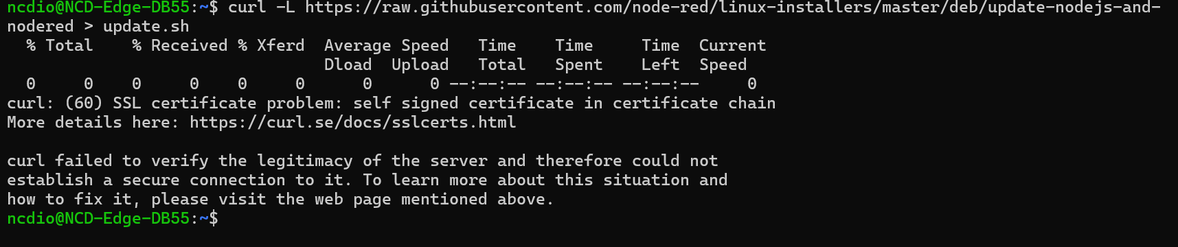

Hi @andrewpcc Okay, thank you for the information. Could you please try the following command and let us know if it works?
curl -L https://raw.githubusercontent.com/node-red/linux-installers/master/deb/update-nodejs-and-nodered > update.sh
Eduardo M.

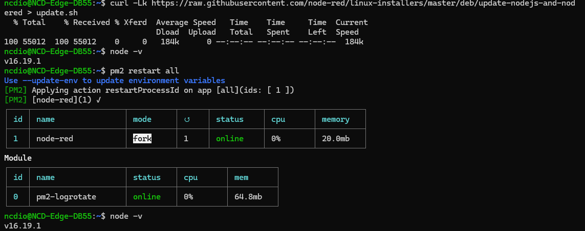

Hi Eduardo,
Thank you for your assistance with this. I tried the command please see result below.
Your Gateway isn’t liking the SSL certificate of GitHub for some reason. You can tell it to ignore this using this command:
bash <(curl -sLk https://raw.githubusercontent.com/node-red/linux-installers/master/deb/update-nodejs-and-nodered) --node20
If that fails try this command to just pull down the file and let us know if it gives any errors:
curl -Lk https://raw.githubusercontent.com/node-red/linux-installers/master/deb/update-nodejs-and-nodered > update.sh
Hi Jacob,
the first command gave me no response, when i entered the second command this seemed to work, the Gateway responded with the below.

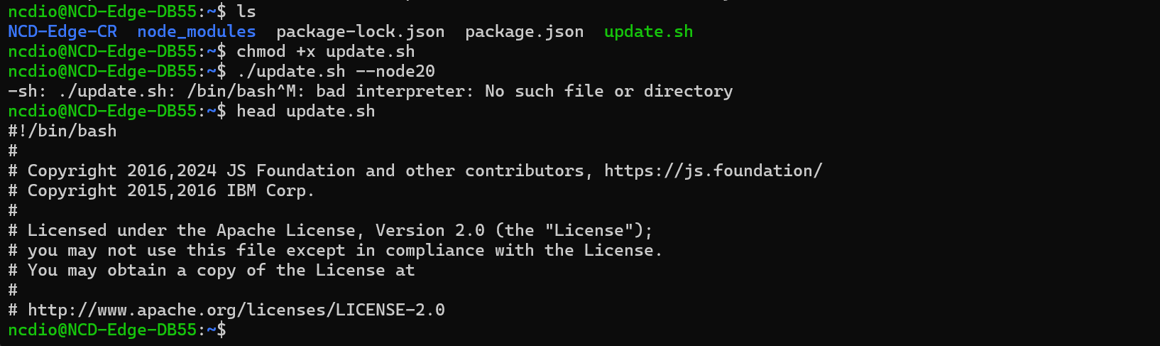

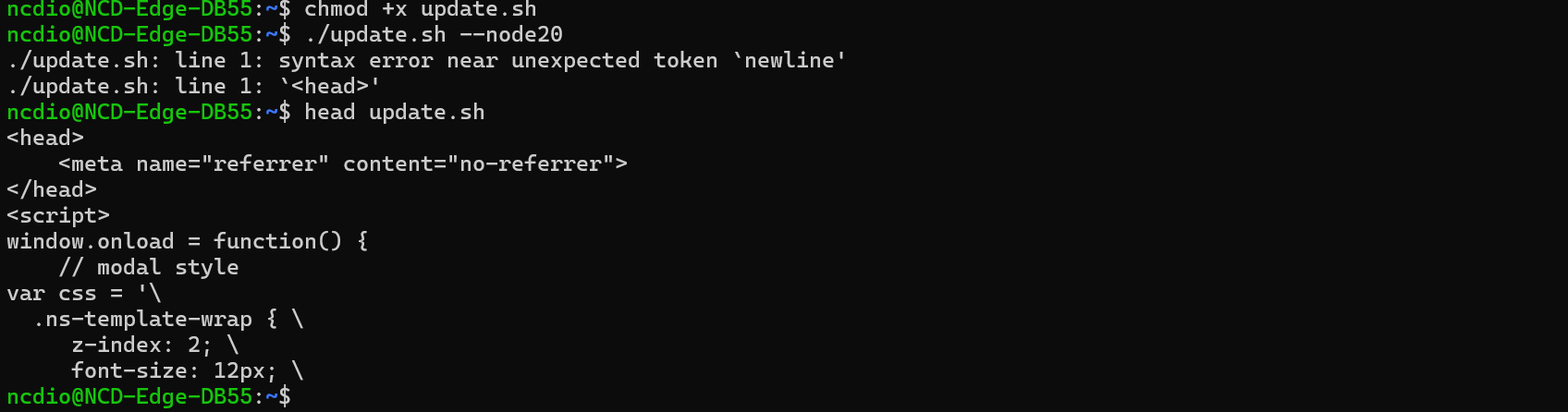

Hi Eduardo,
I tried running the commands however they didnt seem to work. also tried to check that the script is valid by running head update.sh. I have attached the result below:

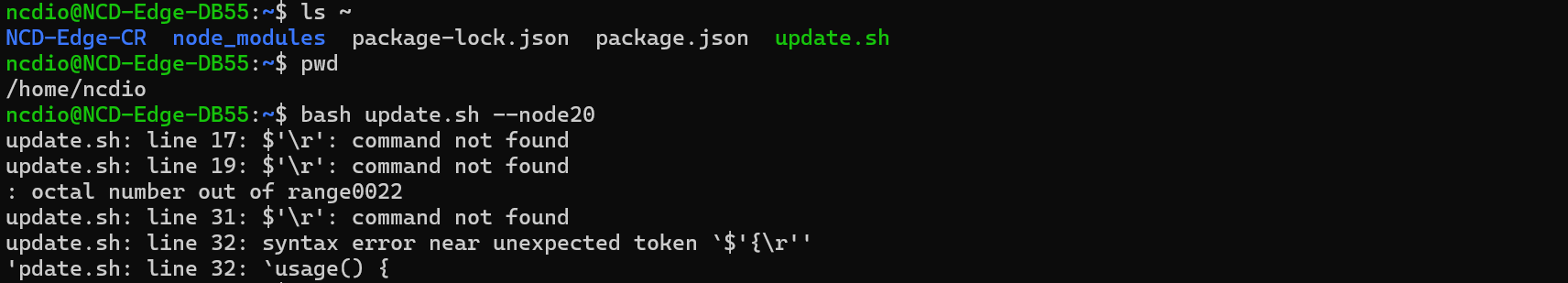

Hi Eduardo,
Another update. I beleive I have managed to get the file onto the Gateway by first downloading the script onto my computer and then transferring it onto the gateway. log below:
You’ll want to run this command if you have the update.sh script in your home folder:
bash update.sh --node20
This should run the script. Let us know if there are any issues during that update. We haven’t encountered an error before.
Hi Jacob,
I tried running the command but the gateway seems to have run into a few errors again please see log below:
