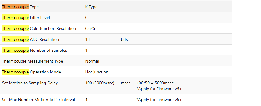

The temperature probe occasionally outputs a random reading of: ext_temperature: -0.01
Completely different from the regular readings.

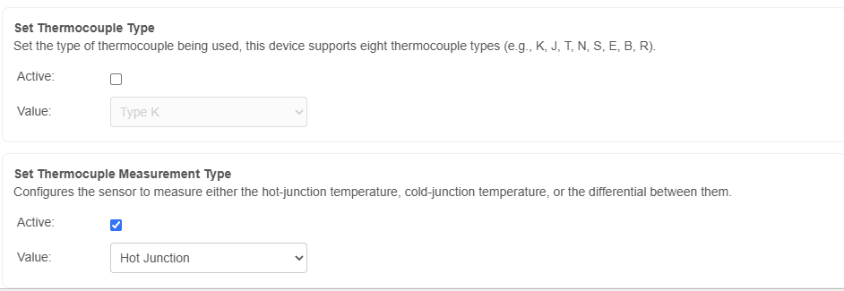

Is there a way to prevent these data hiccups from happening? The configuration page seems to provide less options than what the manual is showing for the thermocouple.
This could happen when the sensor fails to read the thermocouple. Can you share last 1 weeks data ?
