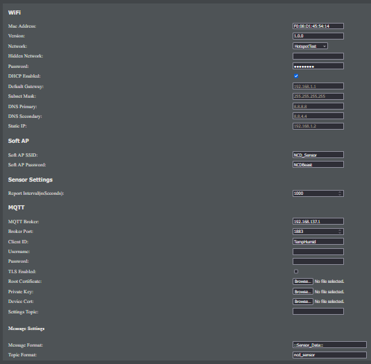

  4. NCD settings:
  • Wifi configured for local hotspot, DCHP enabled;
    • no changes to SoftAP;
    • no changes to Sensor Settings;
  • MQTT:
    • broker ip - see below
    • port - 1883
    • clientid - TempHumid
    • no user, no pass, TLS disabled, no certs, no key, no settings topic
    • message format: ::Sensor_Data::
    • topic format: ncd_sensor

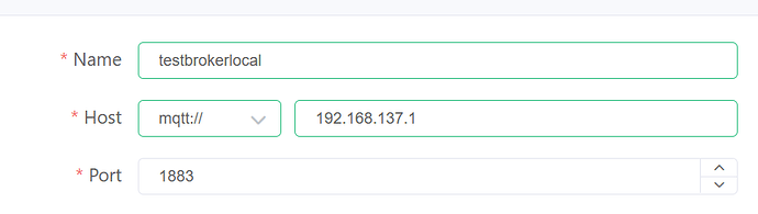

MQTTX settings
NCD settings
I have setup a mosquitto MQTT broker, successfully published, subscribed and read topics from MQTTX and CLI. The desktop running the broker is broadcasting a wifi hotspot. MQTTX is deployed on a separate PC, connected via wifi, & had the broker desktop’s static ip address as the MQTT host address. The NCD sensor is set to the same static ip for the broker address. The NCD sensor successfully connects to the hotspot, but does not connect to the broker using the static IP address of the host desktop.
