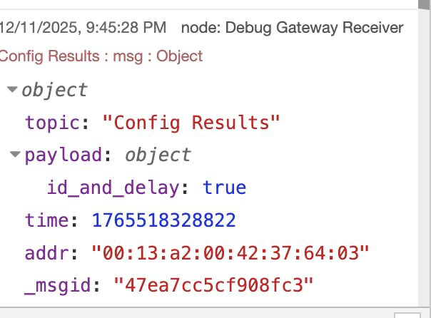

  • we had an extra identical unit on hand from purchase 6 months ago - we were able to configure it on the first try, no issues. Exact settings as the first one.
Here is some information showing node red packets:
SUCCESSFUL CONFIGURATION (SENSOR PURCHASED 6 MONTHS AGO)

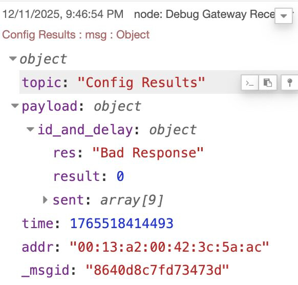

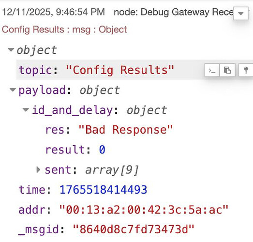

BAD RESPONSE:

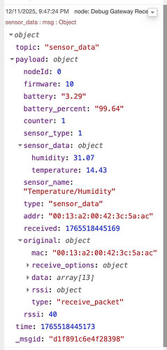

BAD RESPONSE SENSOR SHOWING NORMAL PACKET WHEN PRESSING R
{“topic”:“sensor_data”,“payload”:{“nodeId”:0,“firmware”:10,“battery”:“3.29”,“battery_percent”:“99.64”,“counter”:1,“sensor_type”:1,“sensor_data”:{“humidity”:31.07,“temperature”:14.43},“sensor_name”:“Temperature/Humidity”,“type”:“sensor_data”,“addr”:“00:13:a2:00:42:3c:5a:ac”,“received”:1765518445169,“original”:{“mac”:“00:13:a2:00:42:3c:5a:ac”,“receive_options”:{“ack”:0,“broadcast”:0,“type”:“”},“data”:[127,0,10,3,255,1,0,1,0,12,35,5,163],“rssi”:{},“type”:“receive_packet”},“rssi”:40},“time”:1765518445173,“_msgid”:“d1f891c6e4f28398”}

Unfortunately it appears that this is a bug on the firmware of that sensor for this command. The sensor command goes through in my testing its just erroneously reporting a bad acknowledgement.
