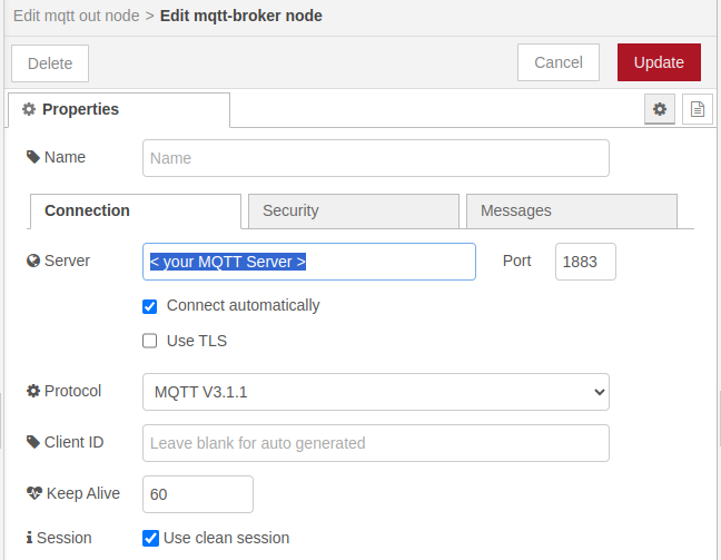

It doesn’t look like my MQTT credentials are working.
We have confirmed the MQTT broker works with other gateways and devices.
I’m unclear where to put the credentials.
“Error: ENOENT: no such file or directory, open ‘path/to/myDeviceCertificate.crt’”
Hi @danempiric thank you for the info, okay let me explain you, to configure the MQTT credentials within the “Out to MQTT” node, you must double-click on the node to access its properties. First, you need to set the Topic to publish to property.
Then, click on the “Edit MQTT-broker config node” icon to configure the MQTT parameters.
Once you access these properties, you will see a window similar to the following:
You should set the address (local or remote) where the MQTT server is located, followed by the communication port configured in the MQTT broker. You can also define the MQTT version (3.1, 3.1.1, or 5). This will depend on the MQTT broker you are working with. Additionally, you will find the Security and Messages tabs, in case the broker incorporates extra layers of security.
I recommend reading an article where we explain how to send data to AWS IoT Core using MQTT. Focus on Section 7 and 8, where each of the parameters of the MQTT nodes within Node-RED is explained in detail. I believe it will be quite useful.
Please take a look at this and feel free to let us know if you have any questions.
Thank you,
Eduardo M.
Thanks! got it working. There was also something funny going on with the ability to push data out from the gateway from my network because I have a nested network. I got it to work perfectly now.

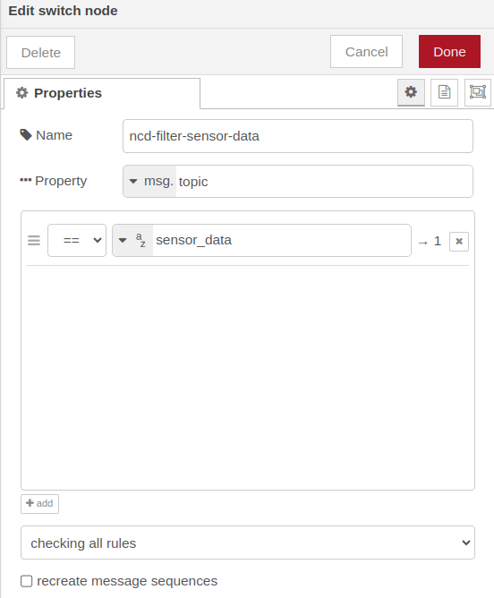

Following back up on this, I was testing the local storage backup by disconnecting the network and waiting for the switchover. Once I did this, I was hoping to get the historical data back. However it seems like I’m just getting error codes now.
Please advise.
Hi @danempiric It’s possible that some sensor or gateway messages from the Wireless Gateway node were stored locally before you added the ‘sensor_data’ node (some modem_mac, sensor_mode, etc). The flow is designed to process ‘sensor_data’ messages, which is likely why the issue is occurring within the ‘Extract Failed Line’ node.
To verify this, before I provide you with a flow to delete the backlog file, could you please send me a screenshot of the configuration inside your ‘sensor_data’ switch node?
Thank you,
Eduardo M.
Hi,
Hi @danempiric I highly recommend reviewing this article to learn about the different types of NCD sensor messages in Node-RED and become familiar with them.
In the switch node, you will need to filter only ‘sensor_data’ messages, as shown in the following image:
To do this, you can delete the ‘addr’ and ‘battery_percent’ rules by clicking the delete button (x) located on the right side.
Afterward, you will need to import the following flow into your workspace:
[{"id":"1c66d34f4837ccb0","type":"exec","z":"adcae456bdd7867d","command":" ","addpay":"payload","append":"","useSpawn":"false","timer":"","winHide":false,"oldrc":false,"name":"exec","x":630,"y":800,"wires":[["dbe362702c2b7126"],["dbe362702c2b7126"],["dbe362702c2b7126"]]},{"id":"65d4cd7400b6789b","type":"inject","z":"adcae456bdd7867d","name":"delete backlog file","props":[],"repeat":"","crontab":"","once":false,"onceDelay":0.1,"topic":"","x":290,"y":800,"wires":[["fb05069e5ec17bde"]]},{"id":"dbe362702c2b7126","type":"debug","z":"adcae456bdd7867d","name":"debug 146","active":true,"tosidebar":true,"console":false,"tostatus":false,"complete":"false","statusVal":"","statusType":"auto","x":790,"y":800,"wires":[]},{"id":"fb05069e5ec17bde","type":"function","z":"adcae456bdd7867d","name":"build command","func":"let filename = flow.get(\"log\");\nmsg.payload = \"rm \" + filename;\nreturn msg;","outputs":1,"timeout":0,"noerr":0,"initialize":"","finalize":"","libs":[],"x":480,"y":800,"wires":[["1c66d34f4837ccb0"]]}]
Then, click ‘Deploy,’ enable the ‘Delete Backlog File’ node, and proceed to delete the backlog file. Finally, you can run the test again.
Please give this a try and let us know the outcome.
Thank you,
Eduardo M.
Thanks! That works now, much appreciated. I actually switch the standard filter node with the NCD node, the preset filters seems to be a bit easier.
