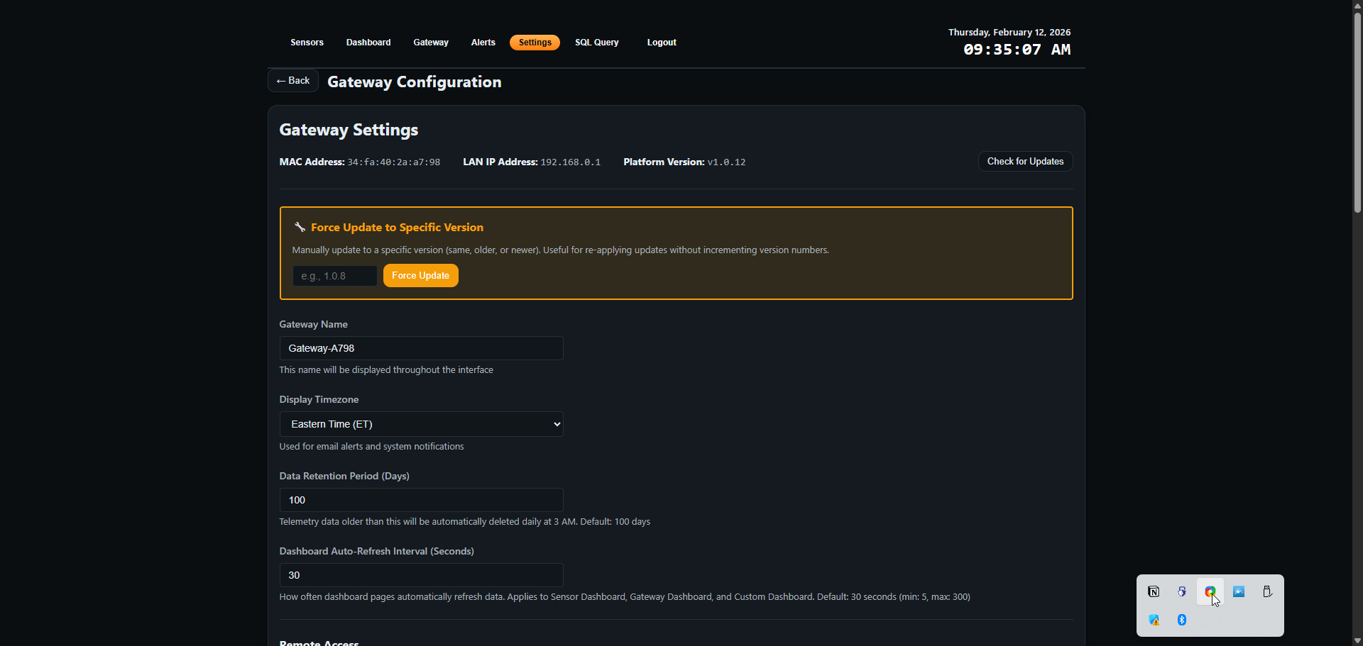

I am trying to set up the network, but have no idea how to get to the setting in the manual I am taken directly into the gateway to see the sensors, no network config.

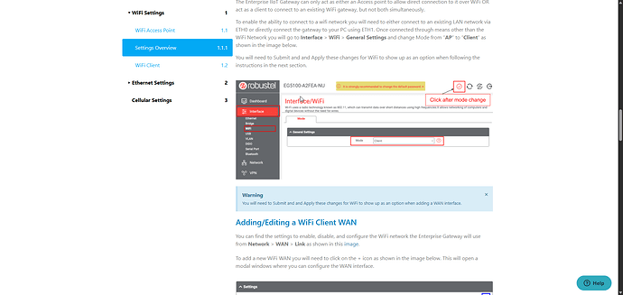

Hi @mturnow sure, you can access the Robustel Dashboard over port 8080 in order to setting up the network. It was moved there so the Atrium Dashboard would be available at port 80.
To access the Robustel dashboard in your browser enter http://ncd-XXXX:8080 where XXXX is replaced with the last 4 digits of your gateway’s Mac address.
Please try this. thanks.
