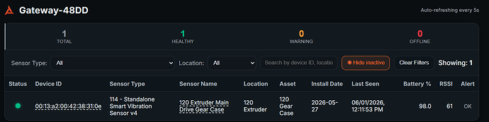

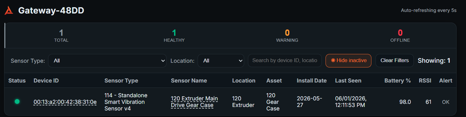

My Atrium Gateway (Gateway-48DD) is working well — sensors are
online and reporting data. However several pages are stuck on
“Loading…” and never load:

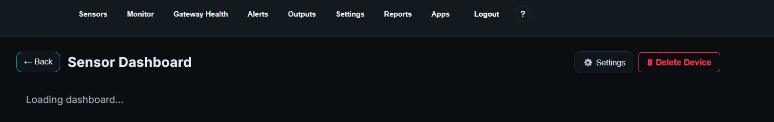

  1. Sensor Dashboard — when I click on a sensor it shows
    “Loading dashboard…” and never loads
  2. Gateway Health Dashboard — shows “Loading…” and never loads

Could you attempt updating the gateway? You can do that through the settings page. If there are any issues with it updating to 1.6.0 please let us know and we can provide a file you can update the gateway from a thumb drive. I’m wondering if that sensor is in Raw mode and your Atrium Gateway has an old enough platform version it does not support Raw Data. Try updating and let me know what you find.
