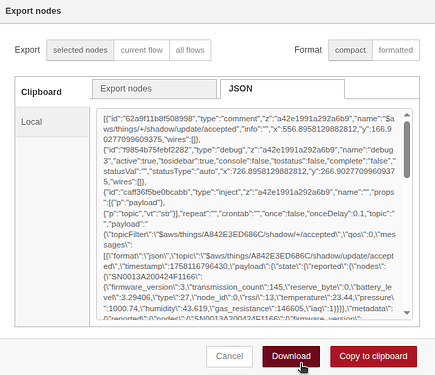

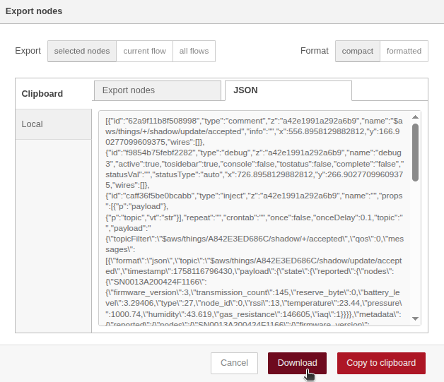

Hi @xtyhyperion could you share a screenshot of your Enterprise IIoT Gateway Node-RED flow? or your Node-RED Flow File, To do so, please follow these steps:
  1. Select your complete Node-RED flow (leaving out any nodes that contain sensitive information such as AWS credentials).
  2. Click the main menu (three horizontal lines in the top-right corner) in Node-RED.
  3. Select the “Export” option.
  4. Ensure the “selected nodes” option is selected.
  5. Click the “Download” button to save the JSON file.
  6. Attach the JSON file to this thread.
Eduardo M.
