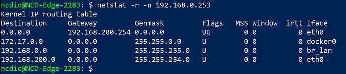

What is the IP address and/or domain name of your ntp server?
If its in the 192.168.0.x range then it may be a conflict of networks as that is the subnet the enterprise gateway uses for its downstream networks so the gateway doesn’t know how to route it.

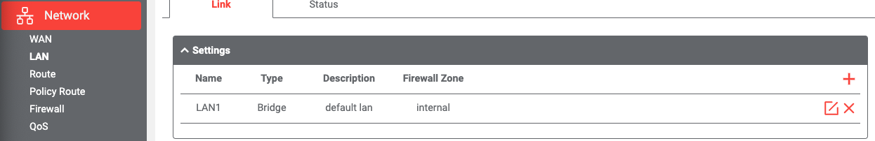

You can change the Enterprise Gateway’s internal network IPs from the Web Configuration pages > Network > LAN > LAN1 > click the edit icon on the right.

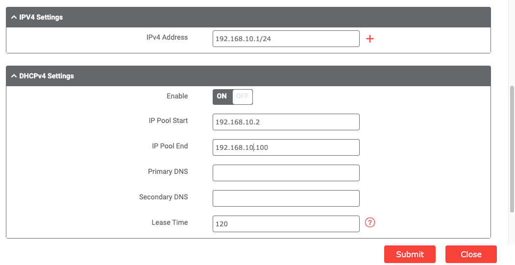

Change the IPv4 Address to something like 192.168.10.1/24
Just make sure to set the settings under DHCPv4 to the same subnet i.e.
Once changed click the submit button and then the red checkmark in the upper right corner of the page.
