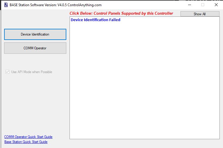

I was able to change the SSID and password to the new one. When I open NCD Base, it will show it as a discovered network device, I can also see it on my IP scanner and router as a client. I hit OK in the Base Station program and the new window opens for coms and says Device Identification Failed. I have been trying to connect via USB as well, but Windows wont allow me to use the suggested port driver, but the light on the dongle board does turn solid red, but when it tries to connect it cant find the correct Baud Rate. Please help.

Yes, that is what I originally tried, and its what gives me the Baud Rate Error. So is there any work around to make the NexGen wifi module work with my controller?
I havent had luck with the XV. It shows up as a device but just wont run when I connect to it. See attached Pics.
I press OK and then get this screen, instead of the screen that should give me the option of which controller I am using.
