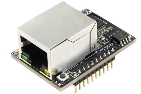

If your relay controllers have an NCD5500 Ethernet module then you can use the inactivity timeout setting to close the client socket from the software after a defined interval. The software should send a packet to the controllers on interval to maintain the socket. This can be configured using the configuration software as explained in the NCD5500 user guide here:
Travis
