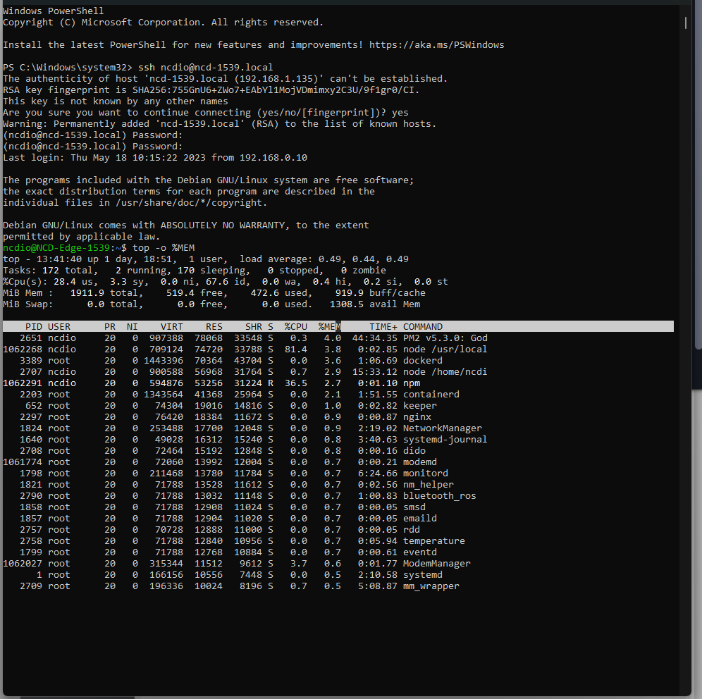

Can go into the command line for one or both of the gateways and send this command:
top -o %MEM
This will tell me what is using the memory on the gateway.

this gateway was at 65% after pm2 restart all. regular restart never made a difference. the other gateway cannot be reached, connection times out.
