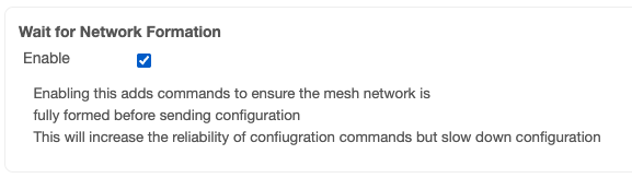

In Node-Red on the Wireless Device node do you have the “Wait for Network Formation” enabled? This option will slow down the configuration by ~4.5 seconds, but it does improve the reliability of configurations.
If that doesn’t help could you let me know which specific sensor type you’re seeing this on, its firmware version, and whether you’re using our Enterprise Gateway when this happens?
OK thank you @jacob we will take a look, I do believe we have that option selected. Appreciate your quick response as always.
I’ll get you more info if we find it necessary, but I think that answers it for now :slight_smile:
