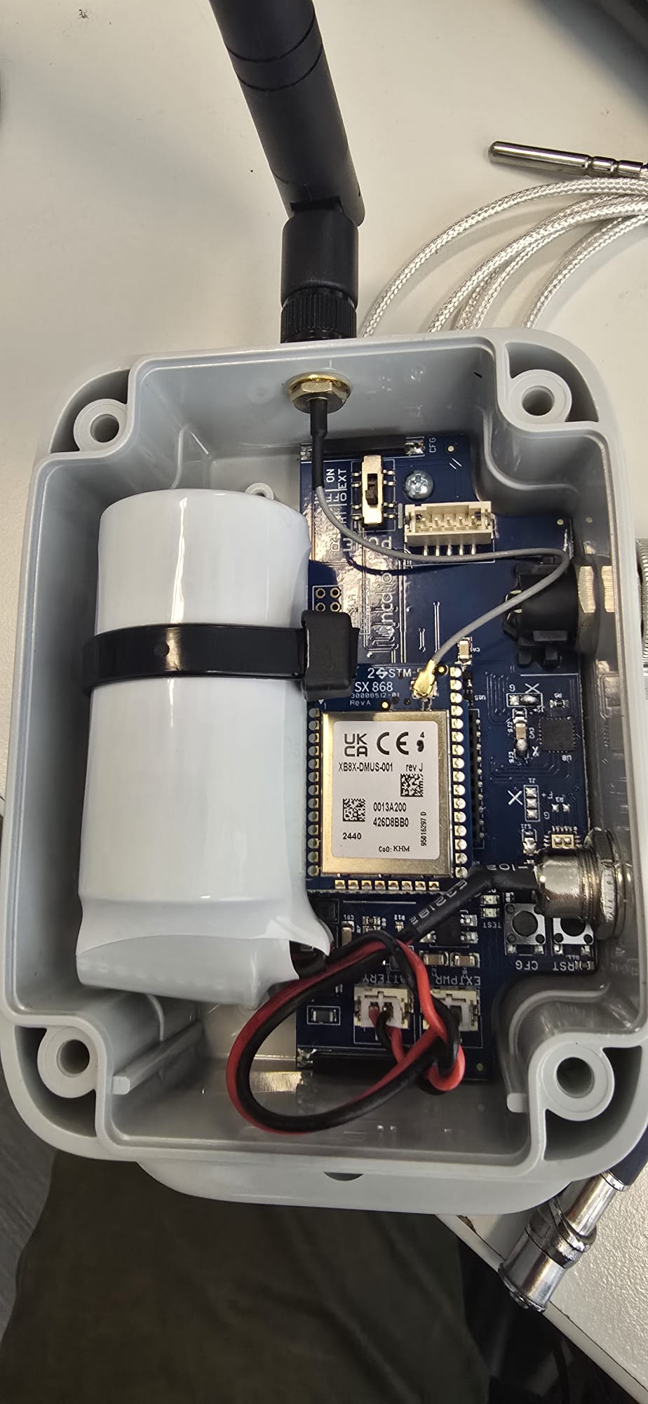

I need to know why alpha station does not pick up this devices. How can i program them?
Pan id, retries, delay, power level node id, destination address and the encryption key.
Also the receiver is new and not picked by alpha station (zigbee to ethernet).
Sensor:
Thanks in advance

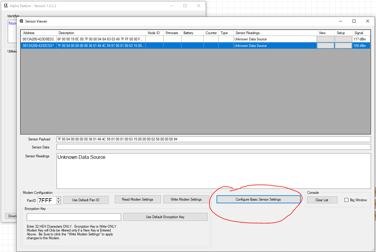

How? How do i set encryption key of sensor and receiver? how do i set al the other fields? Tell me it was deprecated, does not help… Also i need new sensors to talk with receiver configured and maintained with alpha station…
you can configure using Alpha Station as well
ok i am having trouble doing it with alpha station as my first post states.
How can i do what i need with red node? And why would alpha station fail detect the sensors / or the key may be wrong.

If Alpha Station is not detecting anything, it means the network id or eny key might be diff.
At the moment it fails to connect. Is there any firmware version i can put in the modem latest one to check that is the issue (edit found 2.6 and using it, same result)
I can view sensor data if i put zigbee in usb reader and open xctu. but with alpha station i cannot connect to modem, but before i was able to connect to modem but no readings showed.

yes please. i tested other modem and it works to see readings, not to program sensor.
Tell me how.
