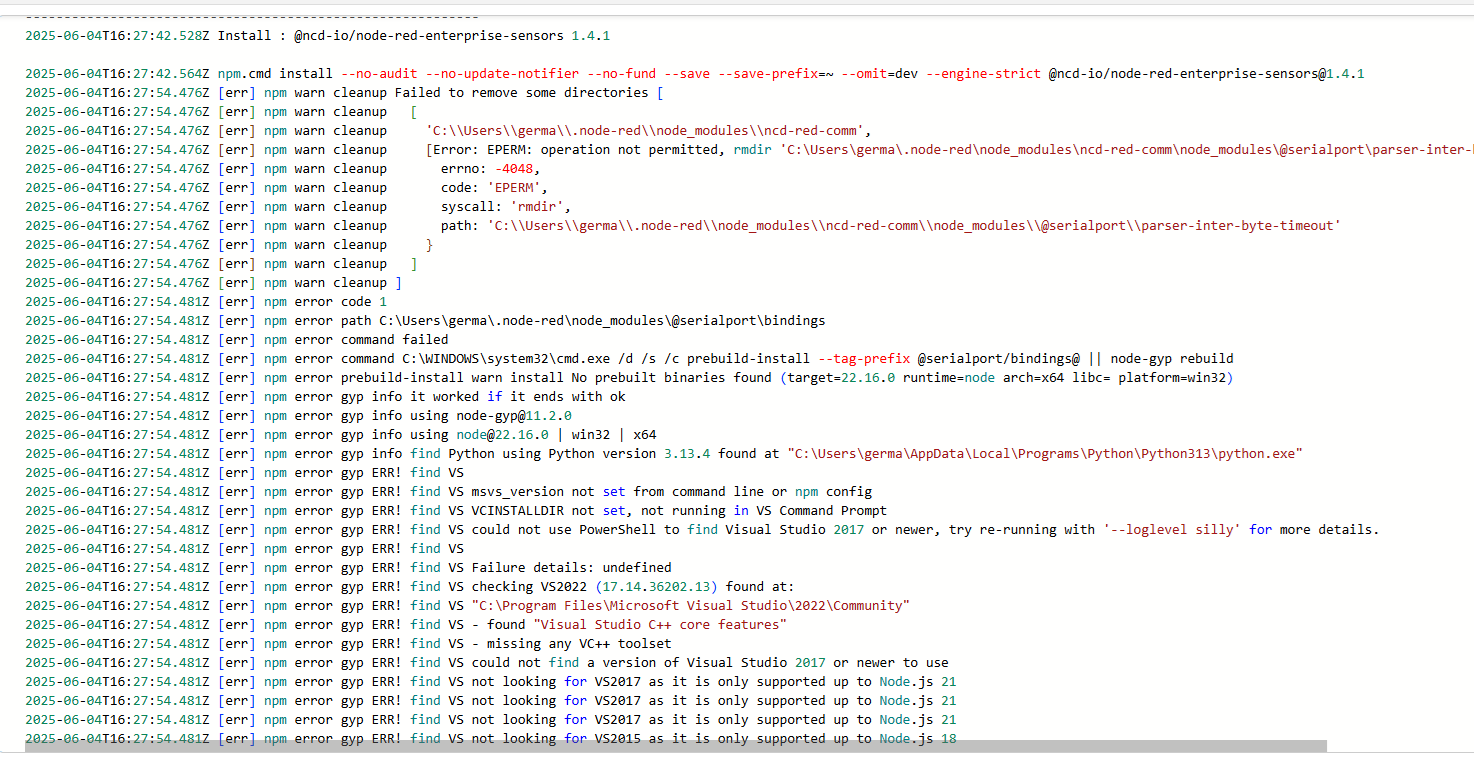

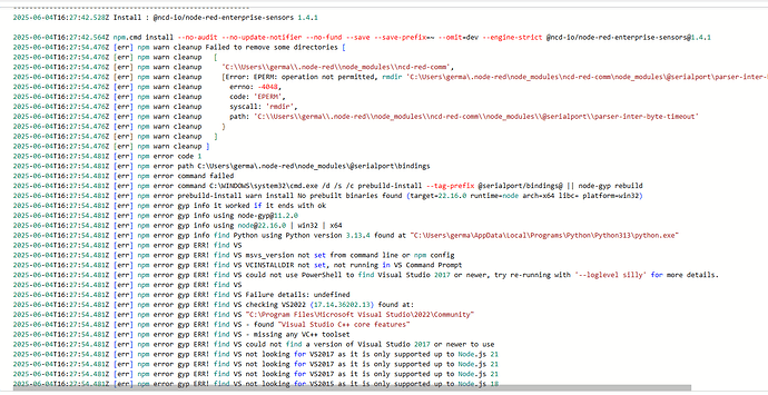

I can´t install NCD nodes in Node red

The issue could be related to Visual Studio Build Tools, which is an important dependency for the node-gyp package. You can try installing Windows Build Tools manually using this link to download the installer:
https://aka.ms/vs/17/release/vs_BuildTools.exe
I’ve attached a pdf with the instructions.
Please try this and let us know if it works or if you have any questions.
