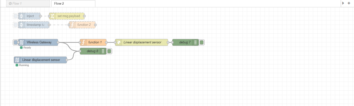

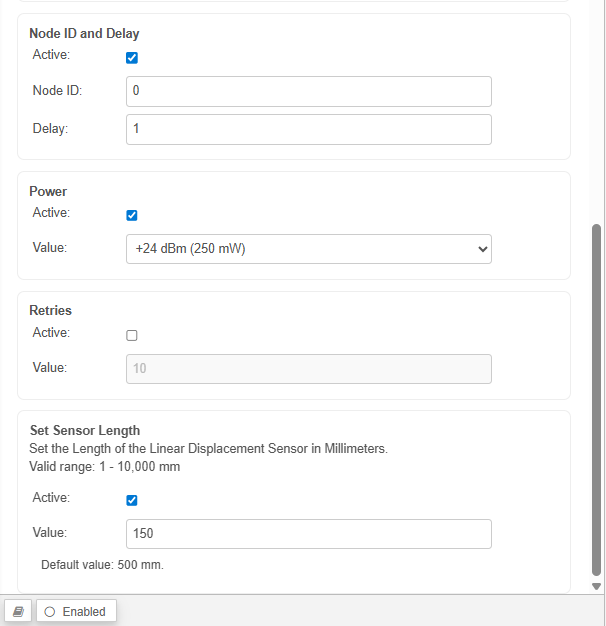

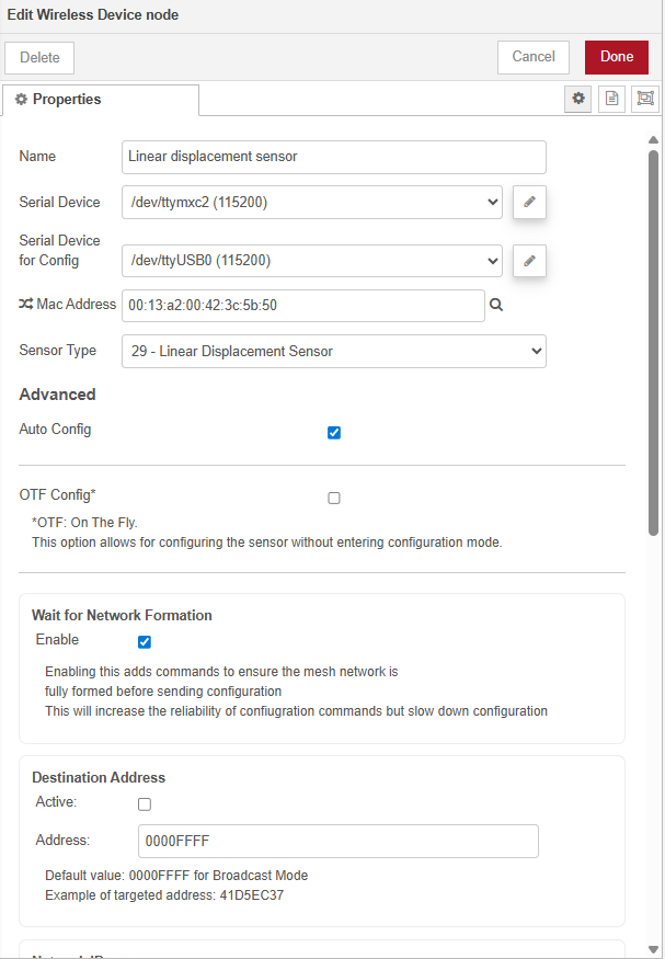

Here are screenshots of my flow and node settings

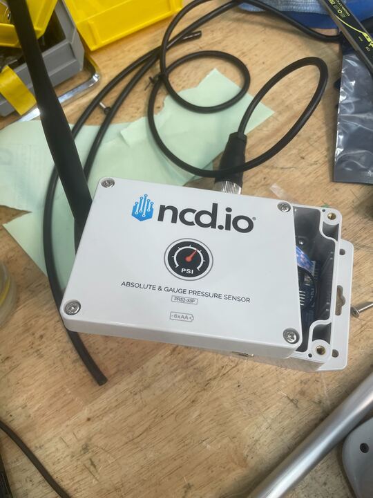

Additionally I’m trying to set up the absolute gauge pressure sensor and the user manual and data sheet links on the ncd website keep turning up 404 errors. I have it connected to the gateway and it shows the “run” and “fly” in the debug, but no sensor information?
Hello @parks It appears that in your Wireless Device node (Linear Displacement Sensor), the “Serial Device for config” is currently set to an invalid port for the Gateway (/dev/ttyUSB0). You should use /dev/ttymxc2 for both options:

  1. Double-click on the Wireless Device node. Set both the Serial Device and Serial Device for config to: /dev/ttymxc2
  2. Enable the Auto Config, OTF Config*, and Wait for network formation checkboxes.

  4. Enable the Set Sensor Length checkbox and enter the desired value (e.g., 150).

Regarding Pressure sensor, could you share a picture of the sensor, please.

The error “TypeError: Cannot read properties of undefined (reading ‘on’)” indicates there’s a node improperly configured in your flow. I can’t say for sure which on it is, but I’m guessing its the Linear Displacement Node.
Click on the menu in the top right (three horizontal lines) > Configuration nodes. Now look for a section titled “ncd-gateway-config”. There should only be one item in this list. If there are multiple delete all of them but one /dev/ttymxc2. If you have multiple /dev/ttymxc2 nodes listed here then most likely a new /dev/ttymxc2 node was added instead of selecting the existing one from the dropdown.
Once those are deleted go ahead and deploy and reconfigure any nodes that may have used the now deleted config nodes and deploy. To clear any trace of these config nodes from memory I would recommend restarting Node-Red or the Gateway.
In essence these configs nodes are the comms handler to the wireless network and only one is required and should be used anywhere needed.
