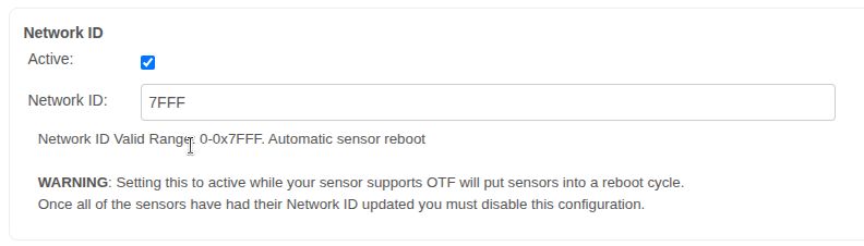

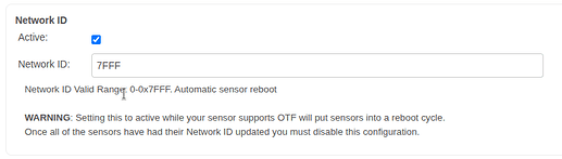

You can easily update the sensor’s Network ID using the Wireless Device node in Node-RED by setting the desired Network ID, be sure to review the warning note in the node’s settings to avoid issues.

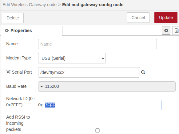

Once you’ve updated the sensor’s Network ID, you can change the Gateway’s Network ID using the Wireless Gateway node. Double-click the node to access its properties, then click the pencil icon to edit the config node, where you can set the Network ID (the default is 0x7FFF, preloaded on all NCD devices).
Click on Done and Deploy to save and apply the settings.
Note: Please note, Network ID 0x7BCD is reserved for configuration and should NEVER be used as a network ID for general use.
