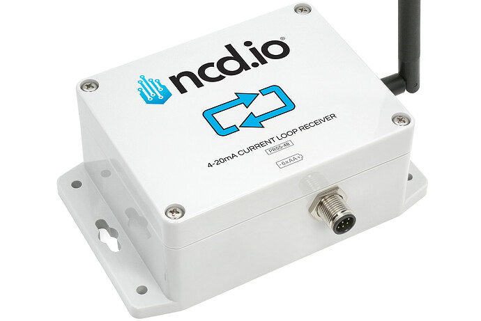

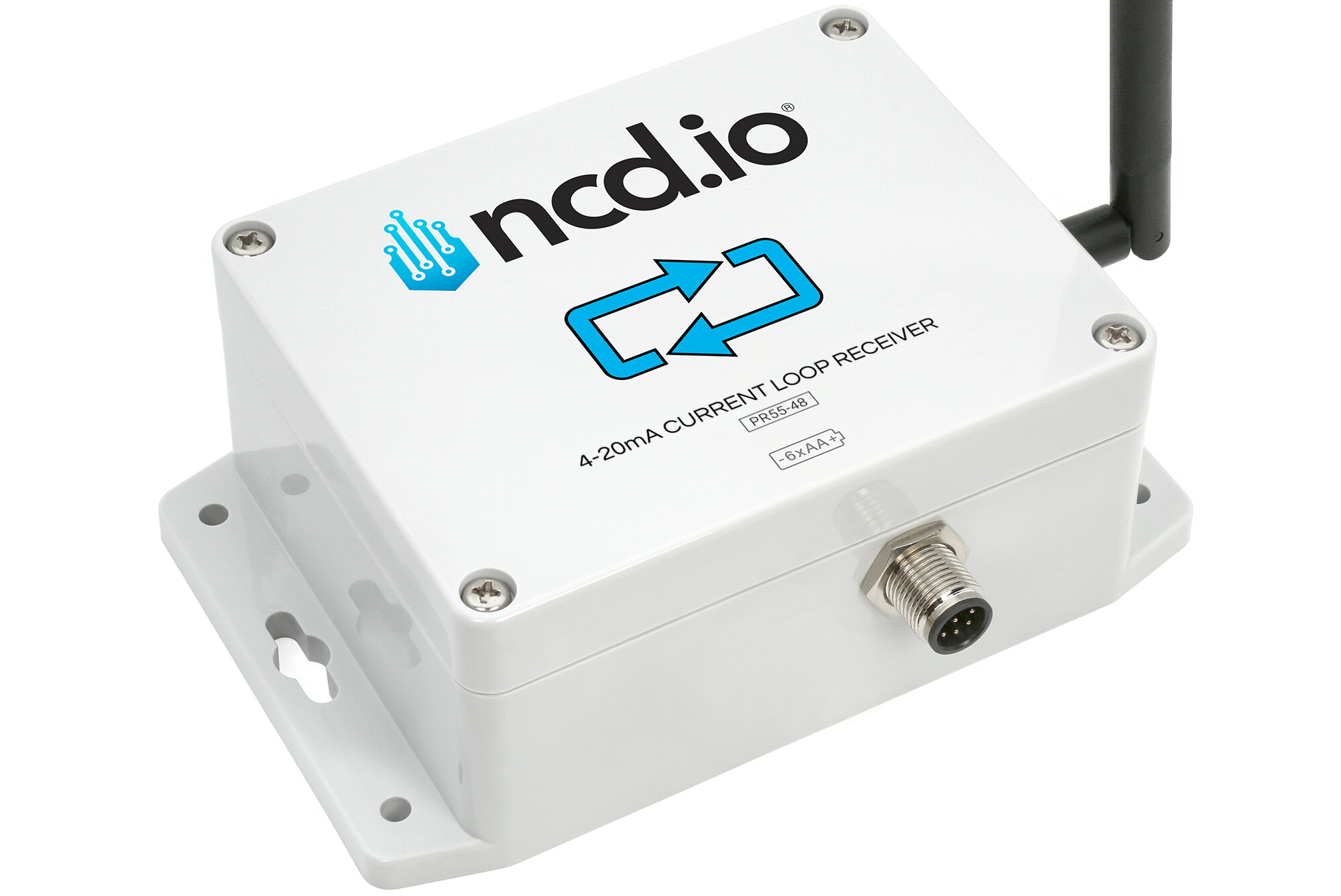

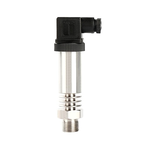

best alternative
4-20mA transmitter
external ​p​ressure sensor
