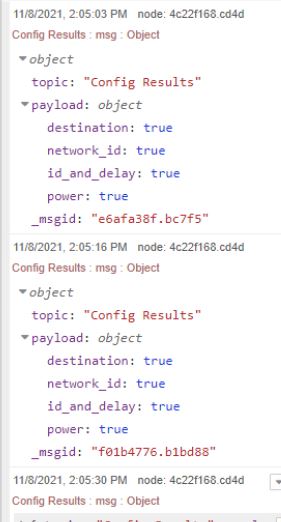

Travis, I just followed your instructions exactly to a T. Here is a screenshot of the results. What version of Node-Red are you using? I’m on v1.2.9. Could that be an issue? ncd-red-wireless version is 1.5.48.
I tried changing the Retries value, Set Filtering, Sampling Interval, and Configure Enabled Axes and this is the results message. It looks like the Retries took:
Try setting the Sampling interval to 30 minutes and let us know what Config results you get on that. I assume thus far you have only tried setting it to 5 minutes.
Nope, nothing. Same result as before.
