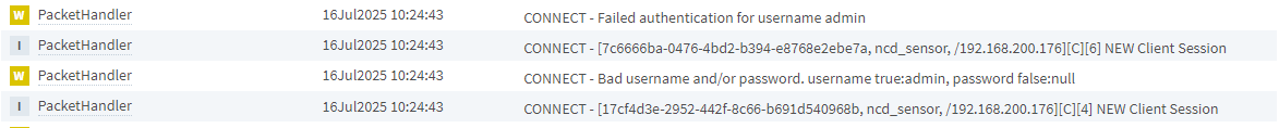

Let me know if your password contains any non alpha/numeric characters.
thanks for the information, now I know that my edge node and MQTT network are both compliant to the same MQTT version.
I went ahead and tested a password with alpha numeric characters (aruba55) and the result was the same.

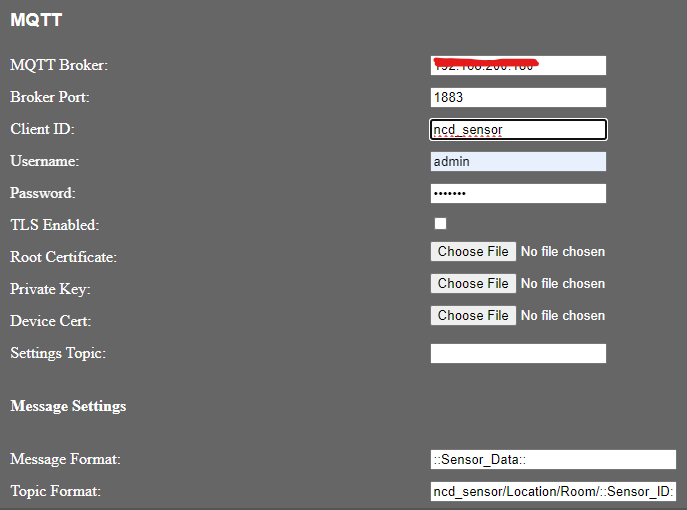

It is hard to imagine why I keep getting this as the device is capable of connecting to my broker, so I will include me gateway settings as well.
I have been trying to crack this problem for quite a while, so anything helps!

I just did a full test with the push notification MQTT unit to make sure it is properly submitting username and password for basic authorization with the broker. Everything is working properly with my MQTT broker when credentials are required. I tested no credentials, username only, and username and password required.
One thing to note I would set Operation Mode setting to 1 so the input change is always published immediately to the broker. Otherwise in the default mode of 2 it will only report when the internal input change counter exceeds the Report Count threshold(I think it’s set to 10 by default so you would have to trigger the input 10 times for it to publish to the broker).
