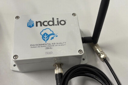

is the new sensor in rectangle box ?
if yes, this is the gen 2 version of the sensor and it has a new device type.
old AWS gateway does not support it.
@TravisE_NCD_Technica will you be able to add this sensor ?
All sensors have the same design.
Old sensor :
New sensor :
