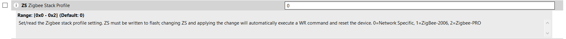

is it possible to use a PR52-33A ( Temperature Humidity Sensor) with a DIGI Gateway? And using the DIGI Zigbee Stack Profile (parameter ZS = 0)?

The processor on that temperature humidity sensor uses the Digi Mesh API to communicate with the on board module. If you install the Zigbee profile on the module that API is different and the processor will not be able to communicate with it so it will not work with the Zigbee profile.
It’s possible you could use it with a Digi Gateway, but the raw data from the sensor would need to be parsed into real world values. My question would be why use the Digi Gateway rather than the gateway we offer?
