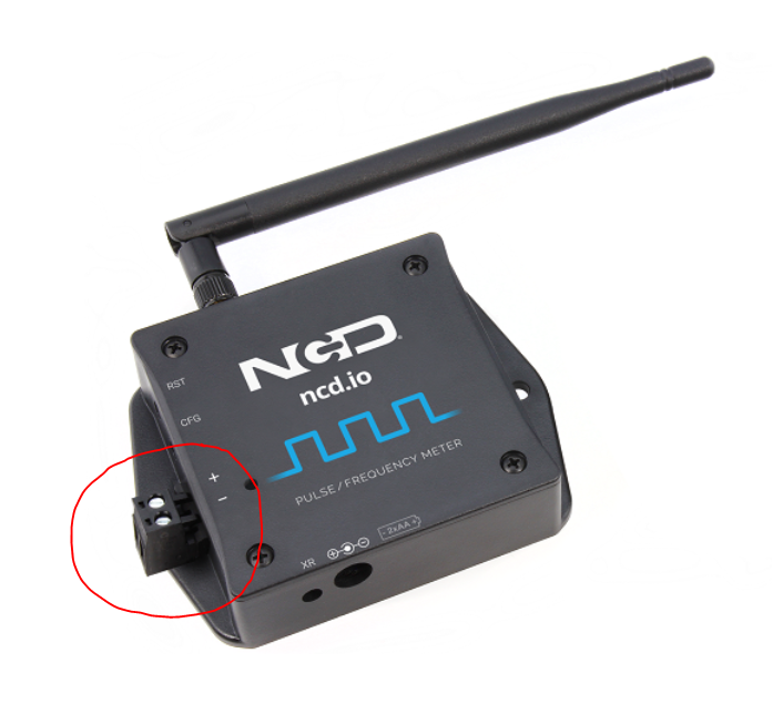

When I check the manual of the product, it is a different device:
Manual: https://ncd.io/blog/iot-wireless-frequency-meter-product-manual/

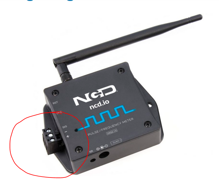

This is what I really have:
I tried:
Connect ground and signal from Frequency Generator.(DON’T WORK)
Connect ground and signal only to “+” and “-”. (DON’T WORK)
Connect an external power supply of 3.3v to “+” and “-”, connect my Frequency generator to “SIG” with shared grounds. (DON’T WORK)
I keeps sending 0 Frequency.
signal should be connected between gnd and Sig.
what’s your pulse voltage level.

That’s the way I tried. My pulse voltage level is 3.3v.
that should work. what s the signal freq ?

I’ve tried many frequencies 100 hz, 200hz even 1khz (Duty 50%), still doesn’t work for some reason.

@Bhaskar no need to check more, I was able to make it work, the problem was my signal generator probe.
