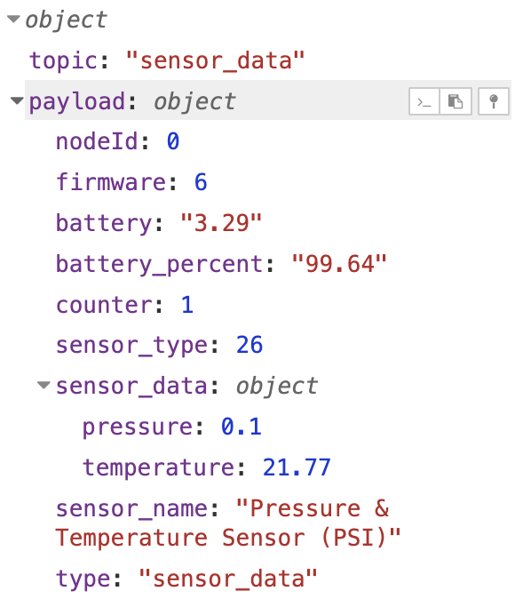

I looked through the debug, and I’m guessing it has something to do with the temp and pressure being in a subsection of payload, “sensor_data: object”, rather than directly in it as battery percentage is:

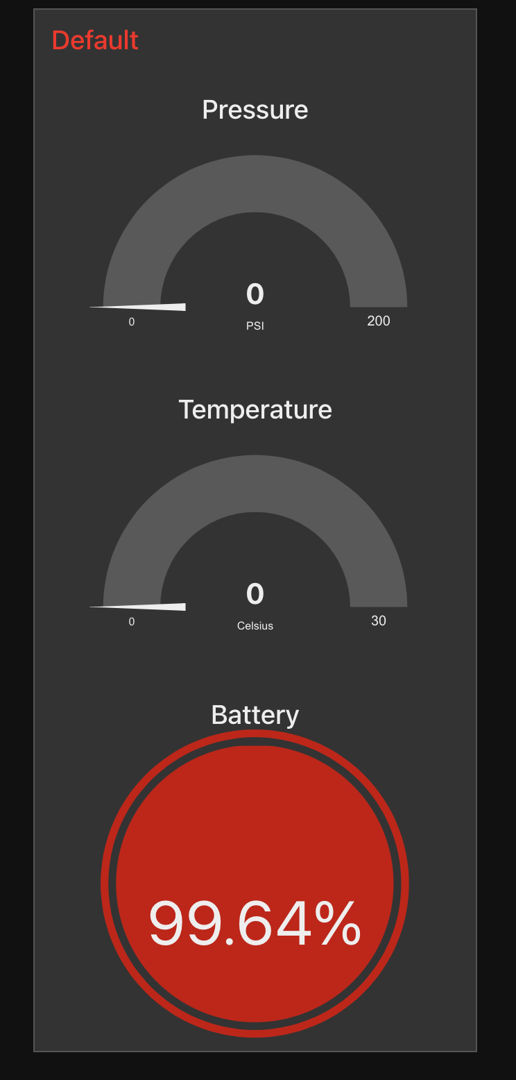

Thank you, that works great. However, I am planning to purchase 3 more of these sensors, how would i separate them into each of their own sections so that i could have each of the sensors showing their data. Also, how would I change the rate at which it sends out data to say, 5 minutes?
