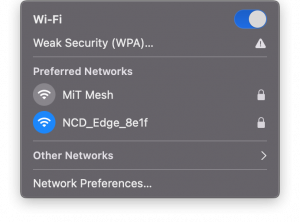

If you have the option, you can verify that a connection has been established between the Enterprise IIoT Gateway Lite and your local network.
