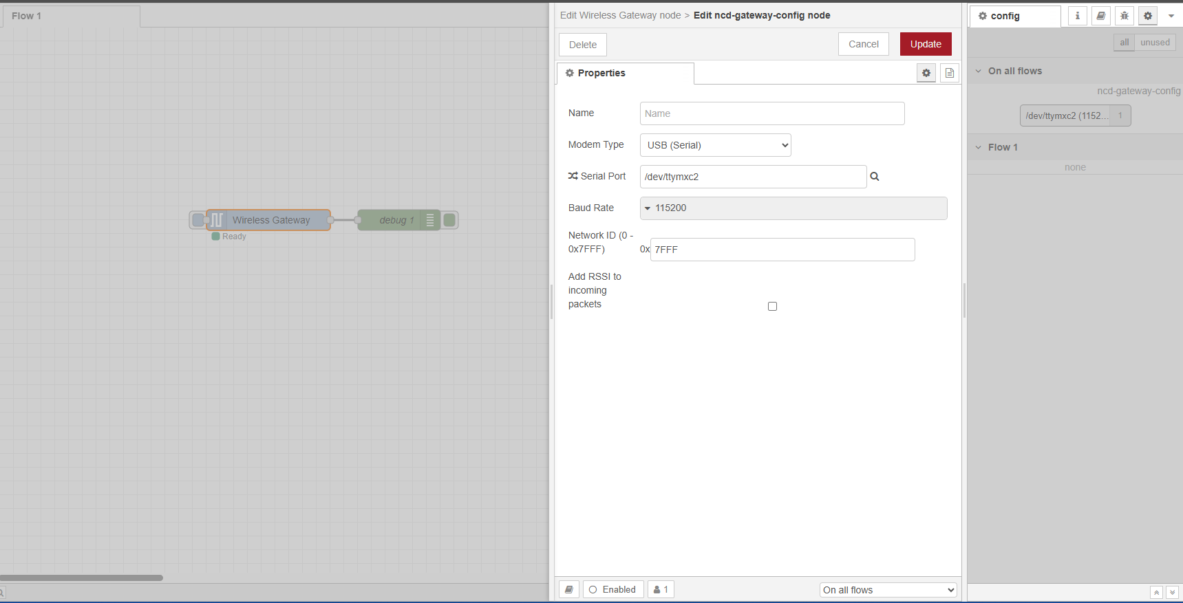

The gateway is powered on, connected to the network, and shows ready in the node-red flow, but I am not seeing any sensor data.
@ncd-io/node-red-enterprise-sensors is on v1.4.5, ncd-red-comm is on v2.0.3, and I’m using v3.1.5 for node-red.

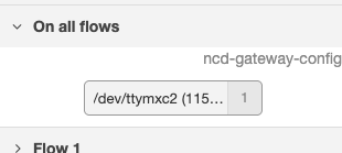

  • Your box has a serial console running on ttymxc1:
    serial-getty@ttymxc1.service active (running)
  • Your flow is also trying /dev/ttymxc2, which doesn’t exist.
  • Result: Node-RED can’t open the right port (wrong device), and if it ever tries ttymxc1 the getty will hold a lock → “Resource temporarily unavailable”.
Have you seen this issue before? I am not sure where to start with this and don’t want to make changes to the hardware without working with your team.

“comm_type”: “serial”,
“ip_address”: “”,
“tcp_port”: “2101”,
“tcp_inactive_timeout_active”: false,
“tcp_inactive_timeout”: “”,
“port”: “/dev/ttymxc2”,
“baudRate”: “115200”,
“pan_id”: “7FFF”,
“rssi”: true

Can you confirm that you don’t have a duplicate serial port configured on node-red? You can find these in the menu in the top right (three horizontal lines) > Configuration nodes. Then look for the section title ncd-gateway-config on the right. It should look like this:
Additionally how does it respond if you change the serial port to /dev/ttyCOM1, update node-red, and then restart node-red?
Good morning Jacob,
After verifying that there is only one active ncd-gateway-config, I changed the configuration to use ttyCOM1, deployed the update, and restarted Node-RED via pm2 restart node-red. The gateway is showing as online and ready, although this was the same result earlier when using ttymxc2—it successfully sends its MAC address once it reaches the ready state. However, I’m still not seeing any sensor data being received by this gateway.
