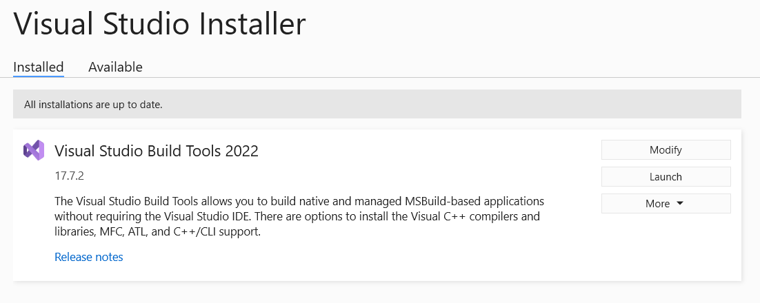

I completed installation of visual studio and the node.js addon, installed node-gyp as well.
