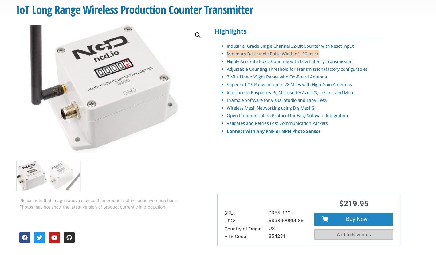

I have a few questions about the IoT Long Range Wireless Production Counter Transmitter: https://store.ncd.io/product/iot-long-range-wireless-production-counter-transmitter/
I see on the specs that the Minimum Detectable Pulse Width is 100 msec.
However, some devices I am looking to hook this up to (gas meter which outputs pulses), have a pulse width of 50 msec or so.
Can NCD configure the minimum pulse width to be lower than 100 msec? 50 or 25?

Is the information on the site incorrect? It says 100 msec, hence my question.
What is the lowest it can be configured to?
