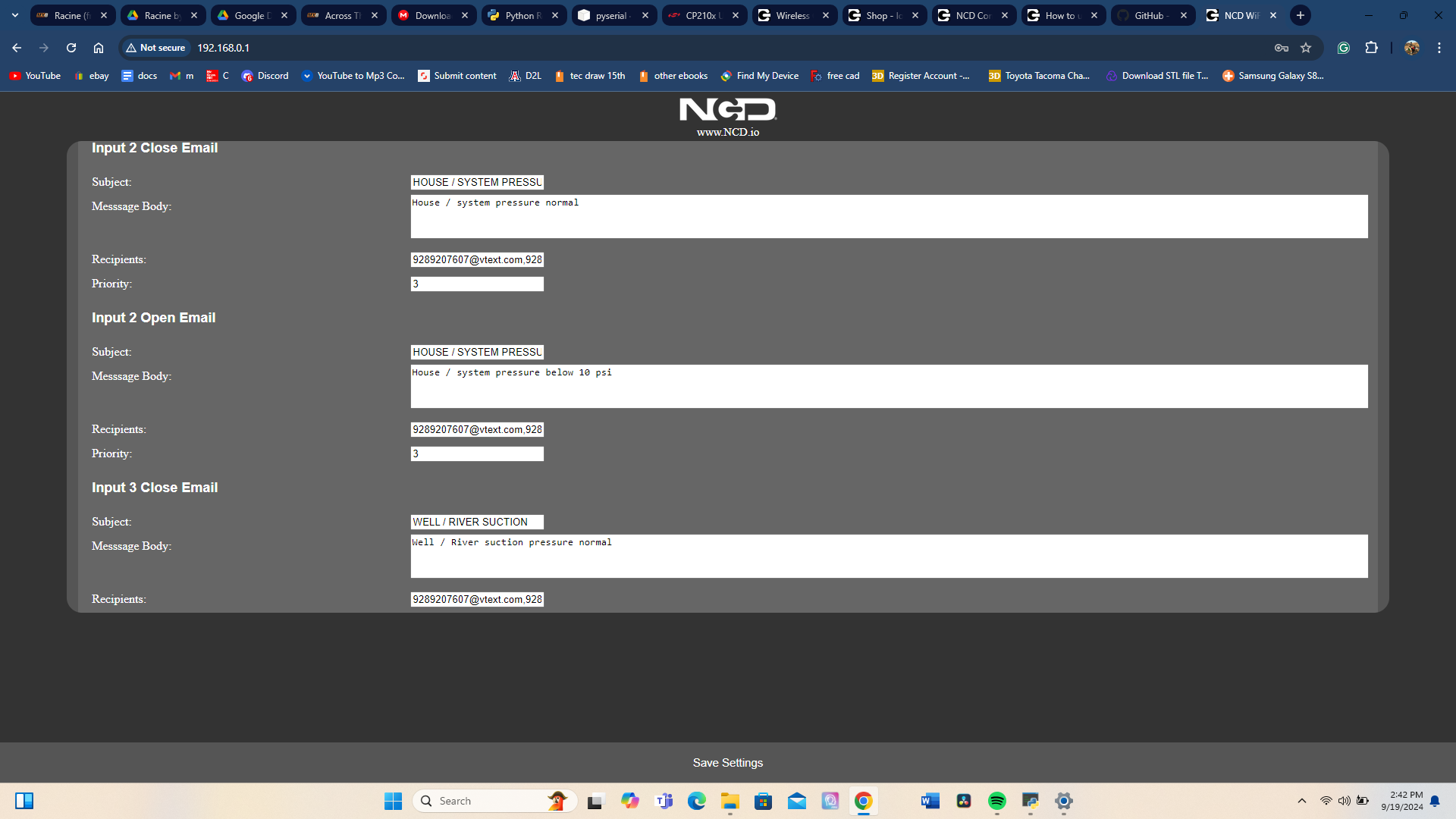

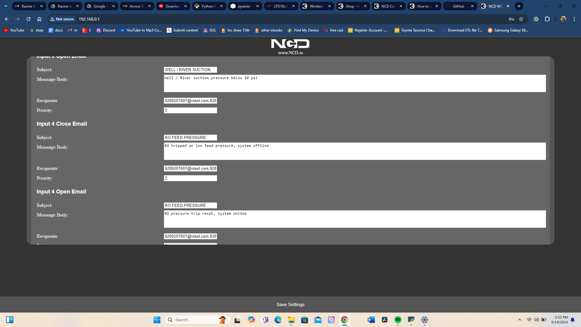

Is there any way you can send a screen shot of the settings you are entering?
after removing all the email addresses from the configure it boots no problem,
4 email adresses in the power on, 4 email addresses in the input 1 close, 4 email addresses in the input 1 open, 4 email addresses in the input 2 close, 4 email addresses in the input 2 open, 3 email addresses in the input 3 close no problem, added a 4th email address to the input 3 close and it bricked again
back to 3 emails in the input 3 close, added one email to the input 3 open and it bricked
