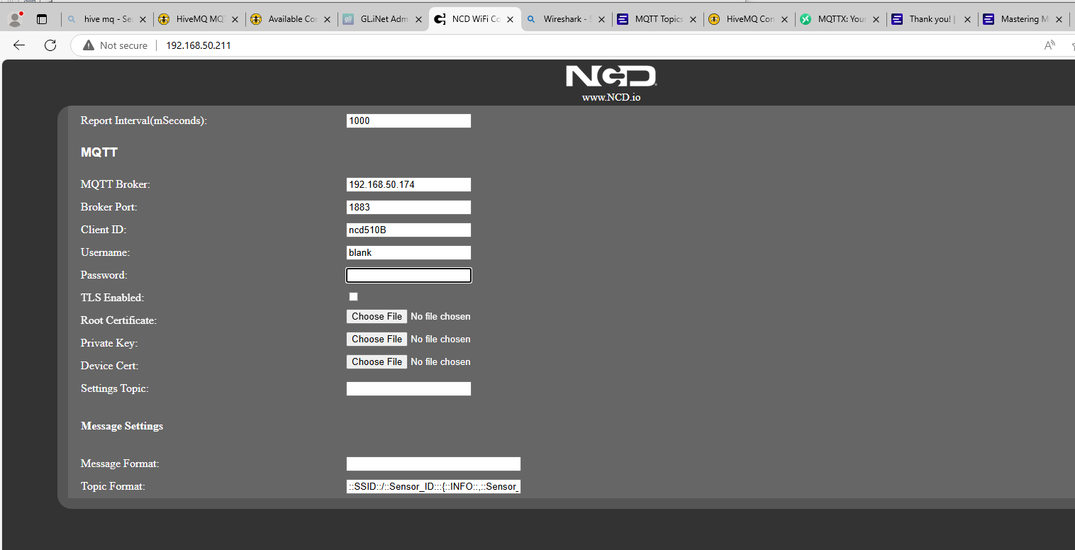

No, The MQTT Gateway does not require a broker that requires a username and password. Enter the text:
blank
For the username on The MQTT Gateway config interface and make sure the TLS setting is off. This will configure the gateway to connect to the broker while only submitting the Client ID on the connection.

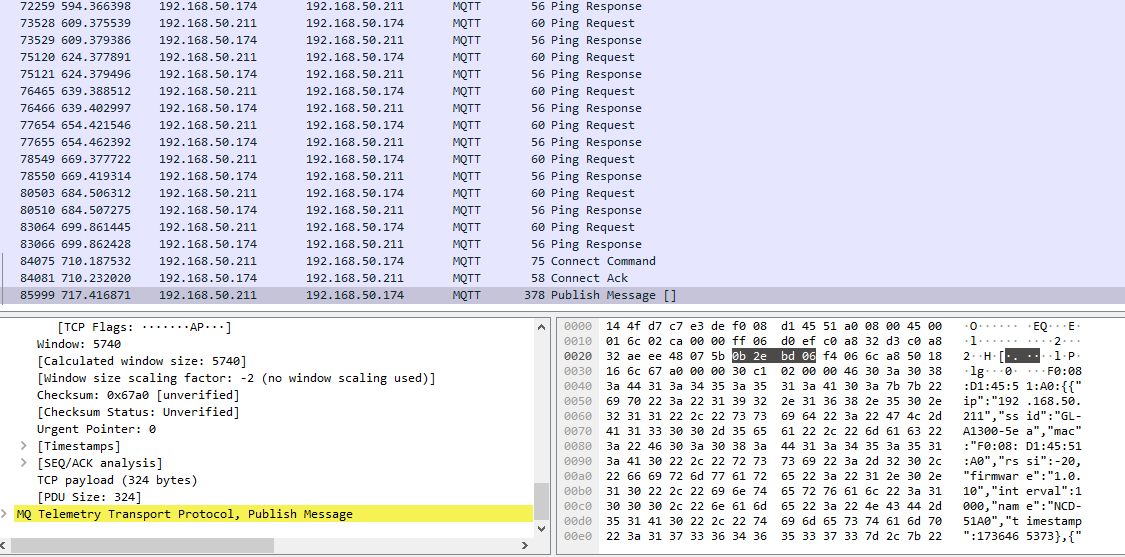

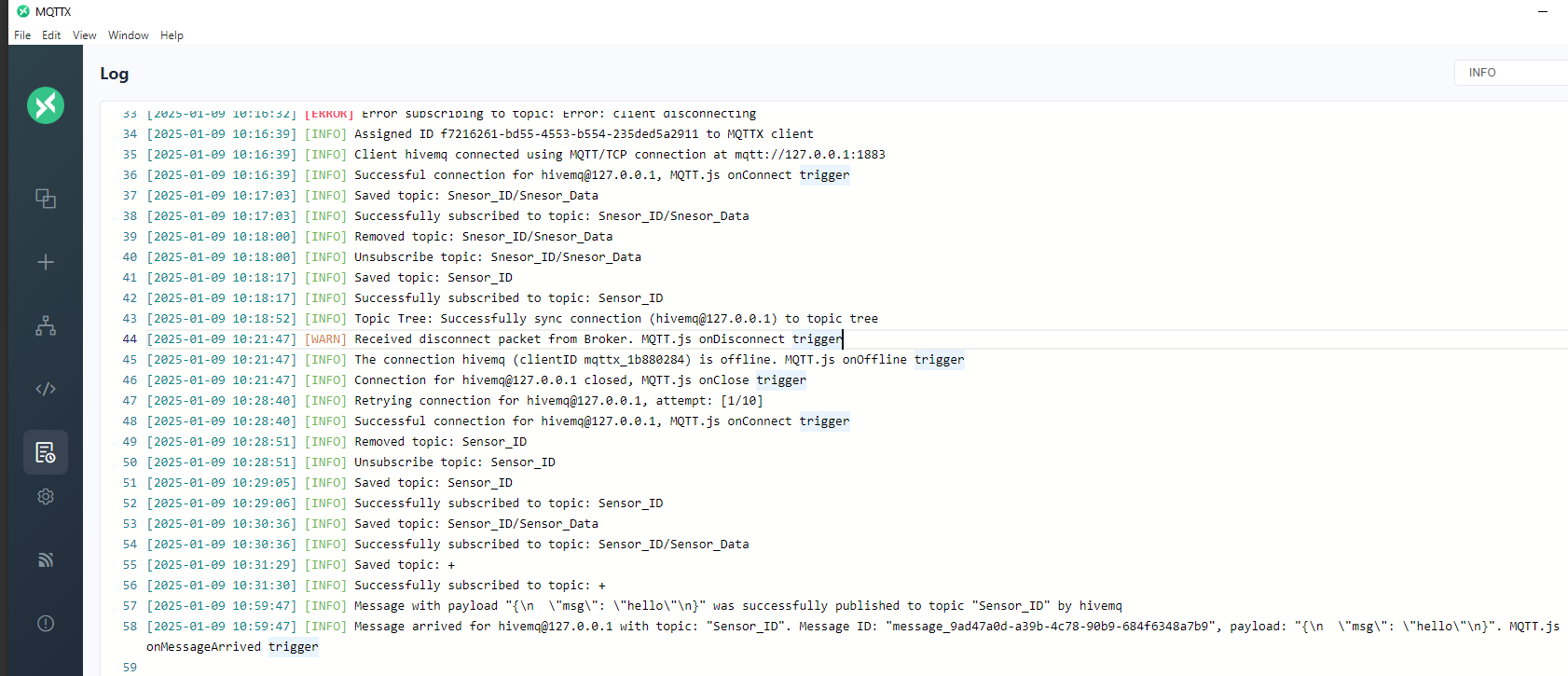

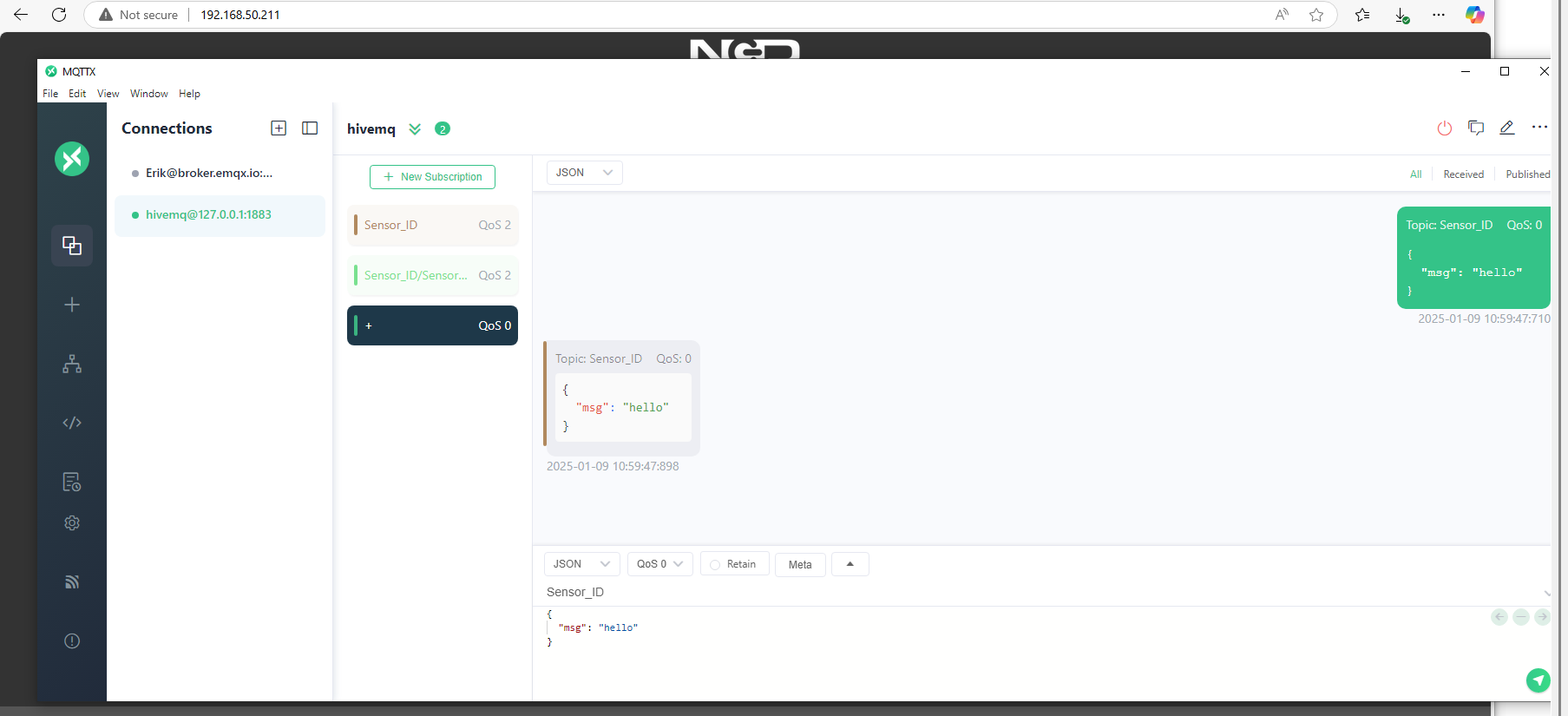

I am seeing that my WiFi MQTT Temperature/Humidity Sensor is connected to a HiveMQ broker (via its dashboard), but the sensor LED is flashing red, and I am seeing only Ping Request & Response messages in Wireshark. I have not configured authentication in the broker and have entered “blank” for the username in the sensors configuration webpage.
I attempted an OTA firmware and filesystem update, one of which jostled it to connect and spit out a single message before bricking? I now only see a faint red led flashing and do not see it in AP mode and cannot get it into config mode either. What are my options to re-attempt the firmware update? What do I need for usb connectivity?
