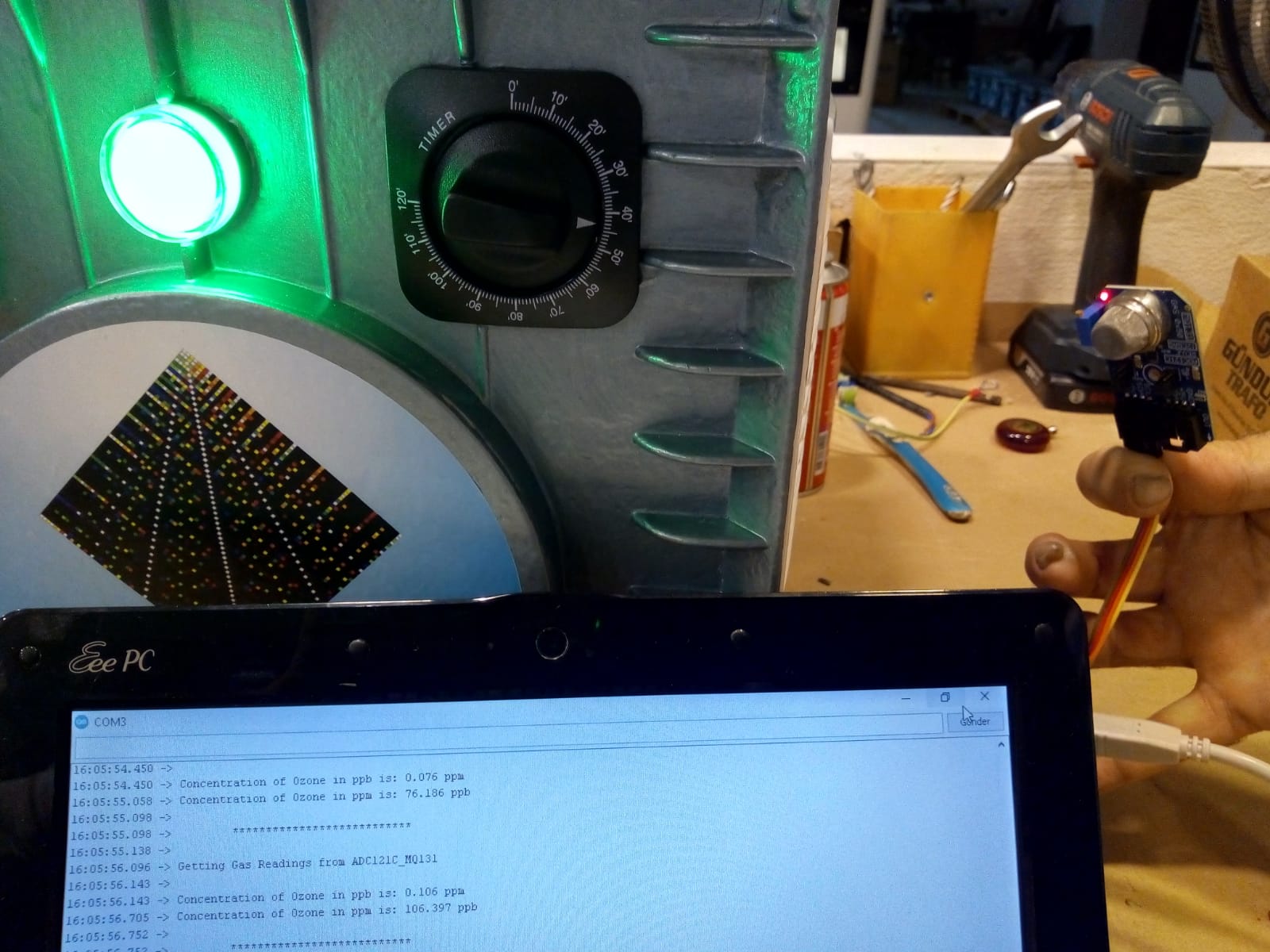

@Bhaskar is there any calibration required for this sensor?
@unluz can you post a photo of your hardware setup just so we can make sure there isn’t a problem there?
@TravisE_NCD_Technica
Here’s our setup and values when the sensor is exposed to ozone gas.
the sensor needs to be powered on for around 48hrs ( sensor warm up time).
The arduino example will need fine tuning and calibration in order to get the best results.
