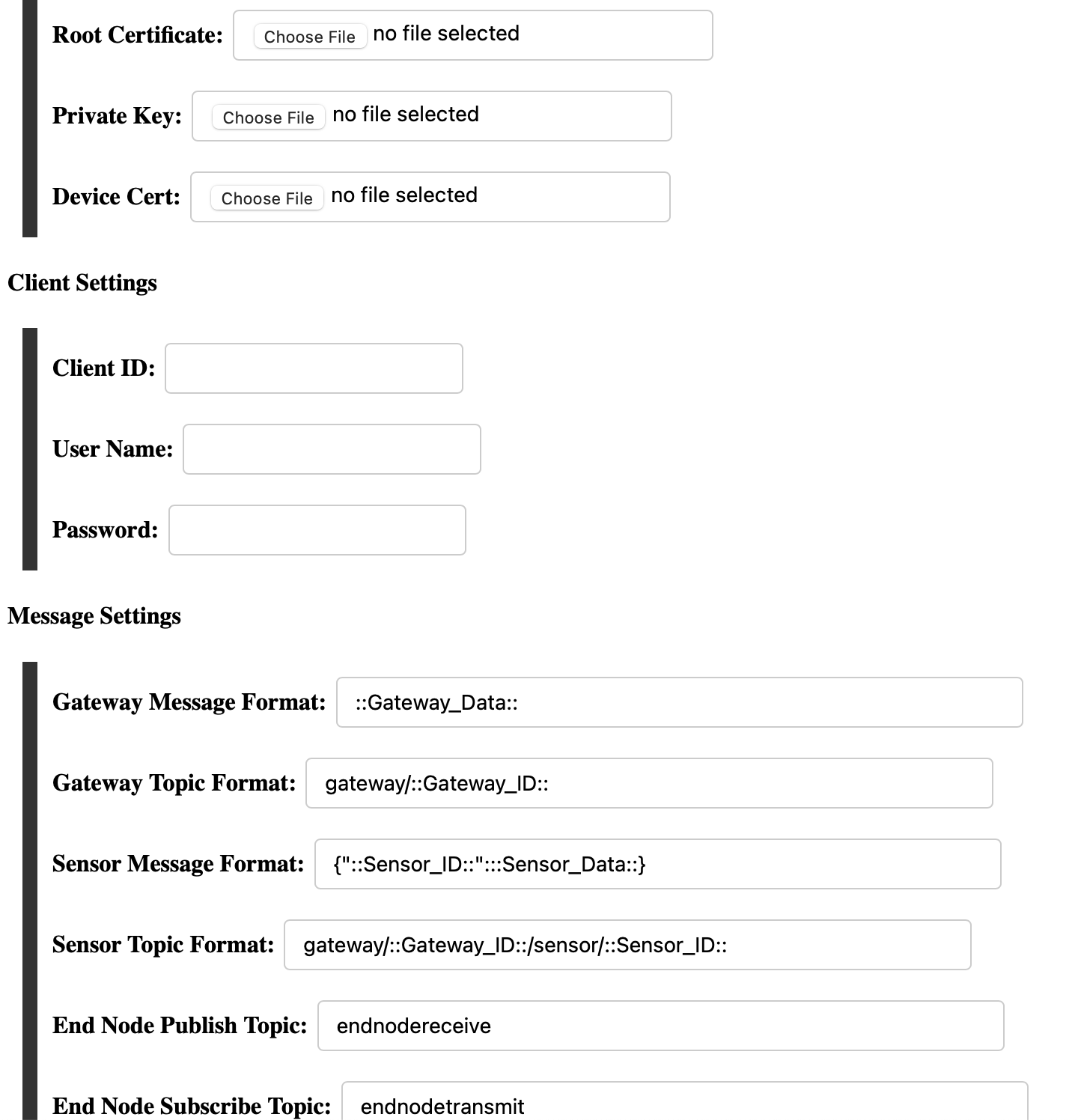

Is there any way you can provide screen shots of the settings you are entering into the MQTT Gateway prior to clicking the Save Settings button?

If you use a tool like MQTT Explorer, are you able to connect to that broker with the config in the screenshot (no username and password)?
