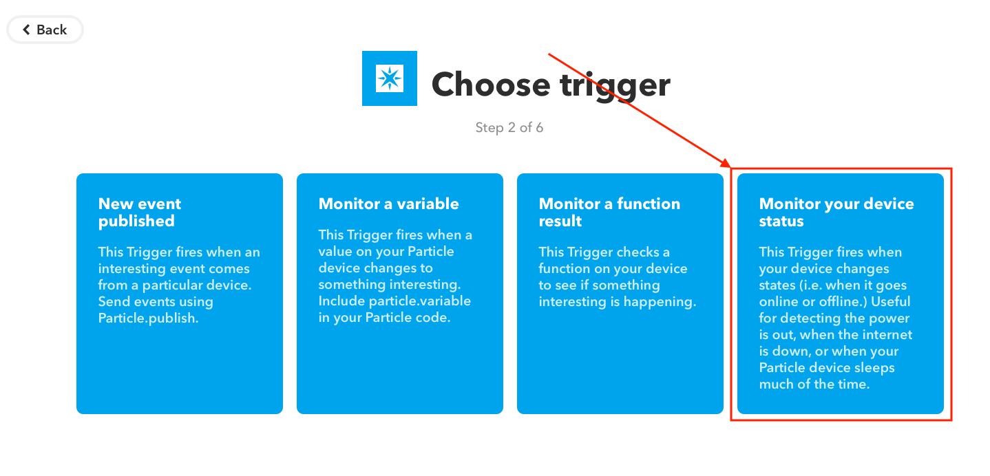

I don’t think I’ve ever actually tried this but Yes, Particle does have an IFTTT trigger called “Monitor your device status”. That should trigger the IFTTT Applet if the device comes online or goes offline. See screen shots here:
Have you tried those? Do they not work? If you tried them and they didn’t work then I’d highly recommend starting a discussion about that on https://community.particle.io

Yes, I’m currently using that Applet. Which works, though it sends the same alert for loss of network and loss of power alert. Our maintenance staff would only need to know about a power outage. It sounds like I’d need to set up a UPS with the NCD device and add a sensor for detecting power at the unit in question. I’m sure there’s a solution already here on the board somewhere. Thanks again!
