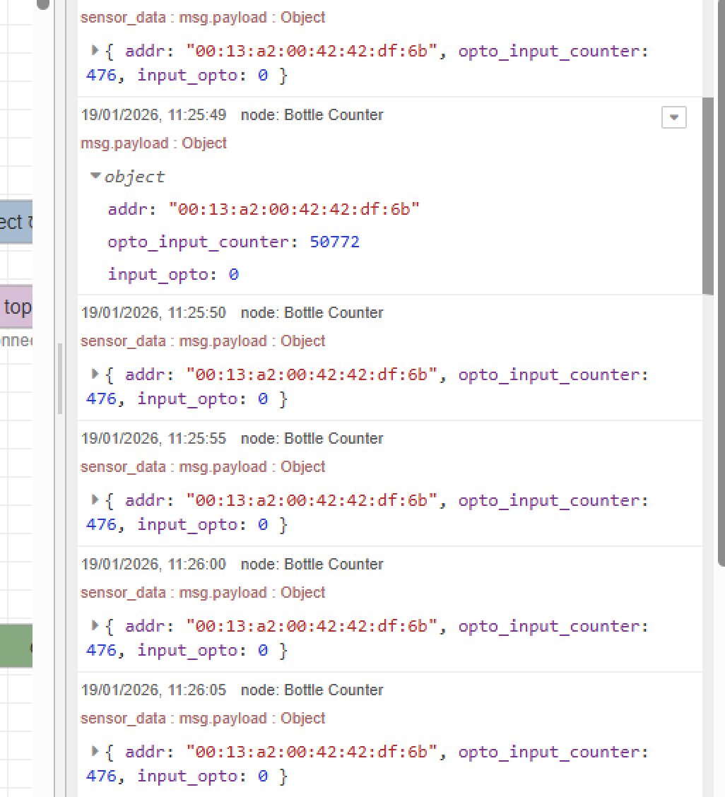

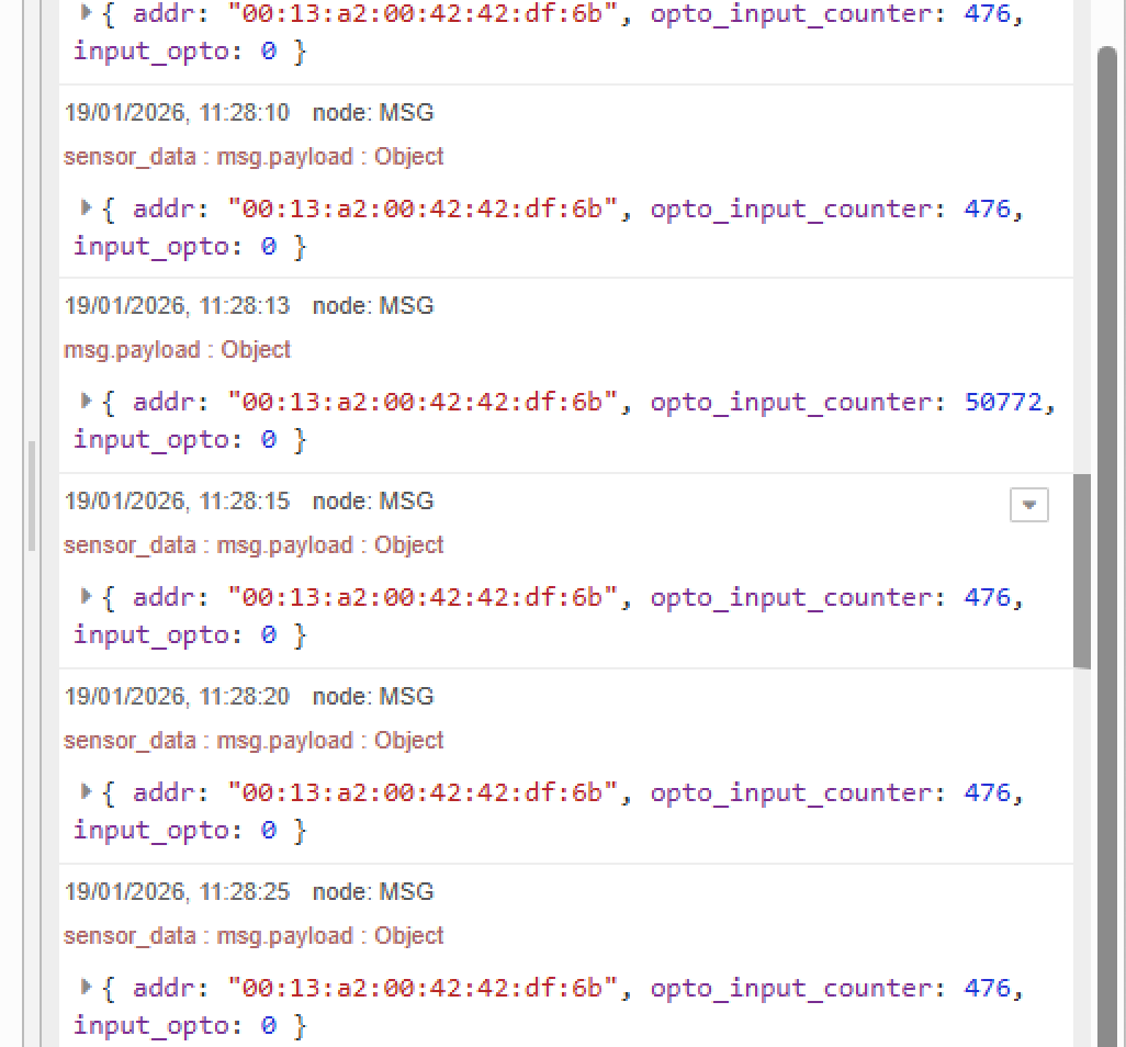

I seem to have an issue with an optical counter that I have installed. It seems to be holding 2 data points for the field ‘opto_input_counter’.
As you can see in this screen shot it appears to show 50772 and 476 almost simultaneously.
I did notice that this started to occur Dec 31 so not sure if it might be related to the changing of the new year. I also notice that our other counter stop incrementing on Dec 31 as well. It appears that it is holding two different values for the RTC, one is 22:54 and the other is showing 7:48.
