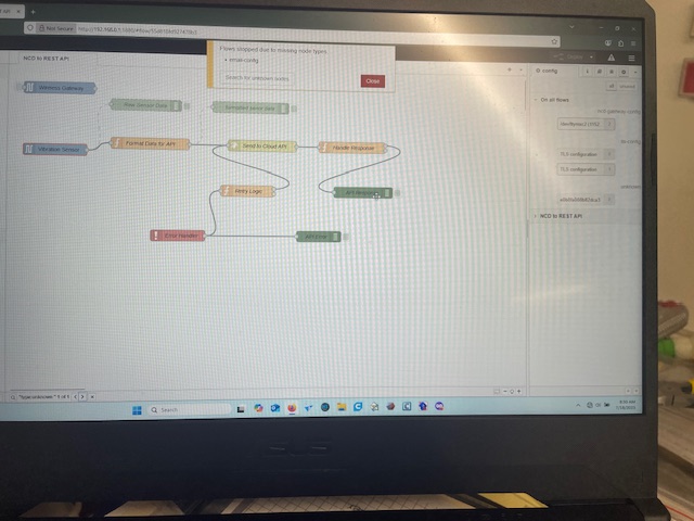

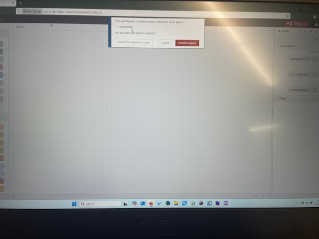

For some reason, we are unable to update an existing Flow on Node-Red. We are getting a error message that indicates “unknown email config” node, although the referenced node is not used on any of the Flows. We get this error even when we try to deploy an empty Flow! see attached screen shots. The referenced node is the at the bottom of the list and is not used anywhere!
Please advise. Thanks.
This can be caused by either a config node or a subflow in Node-Red. When you see these errors you will see a search for unknown nodes button that will guide you to the node in question. You should just be able to delete the node(s).
You can look at subflows by using the drop down next to the + button that adds new flow tabs (downward arrow) > List subflows.
You can view configuration nodes from the menu in the top right (three horizontal lines) > Configuration nodes.
If I had to guess it would be the config node in the bottom of the list on the right of your images.

Thanks for then feedback. I have done that, however there is no such node any of the flows I have. As you can see from the photos I sent from an empty flow page. Trying to load an empty flow page, still shows the error with the referenced node–which does not exist!
Can you delete this node and see if it resolves the issue:
I have tried. I can not find it any where to delete.
You can see the “referenced” node on the right hand side panel, it is the last one…
You should be able to double click on the node and hit the delete button on the edit pane or click on the node and hit the delete key on your keyboard.
