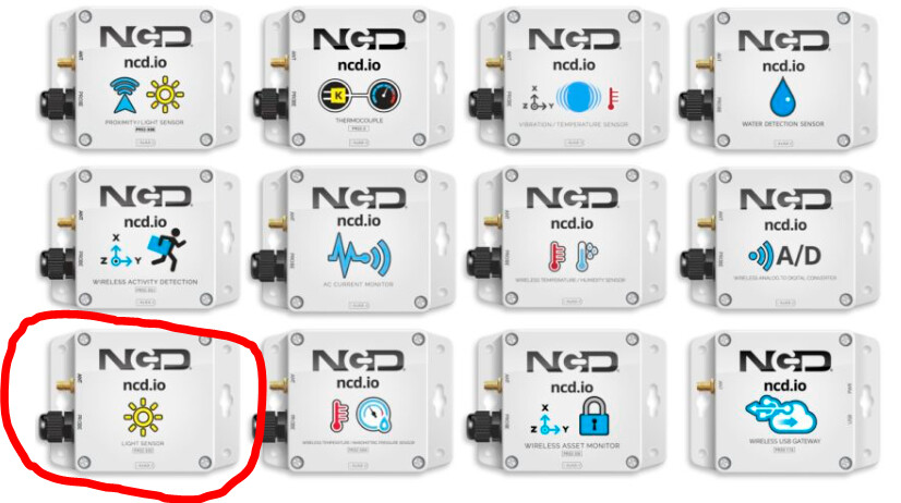

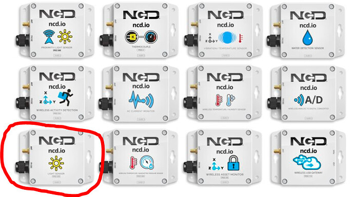

Hi Zach,
I received the board and everything is working properly!
Just one question: I saw that there is light sensor for outdoor but I could not understand how to buy it (see image as reference).
Luca
HI Luca,
How may pcs do you need ?
Hi Bhaskar, I need two pieces
Thx
L
Hi guys, any news on the above mentioned request?
Luca, we can build it but the light probe wont be waterproof.
