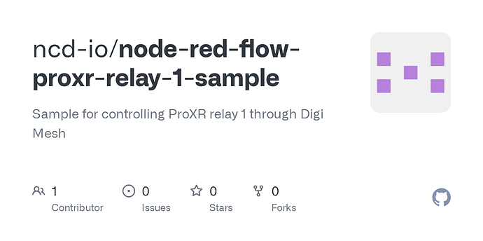

Are you saying that you would like to control relay outputs via Node-Red running on the Enterprise Gateway?
This is possible with our long range wireless ProXR relay controllers. I have a sample Node-Red flow here that demonstrates how that can be accomplished:
If you can let us know how many relay outputs you need I can suggest a board.

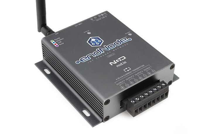

The same can be accomplished with 4-20mA outputs using this device:
