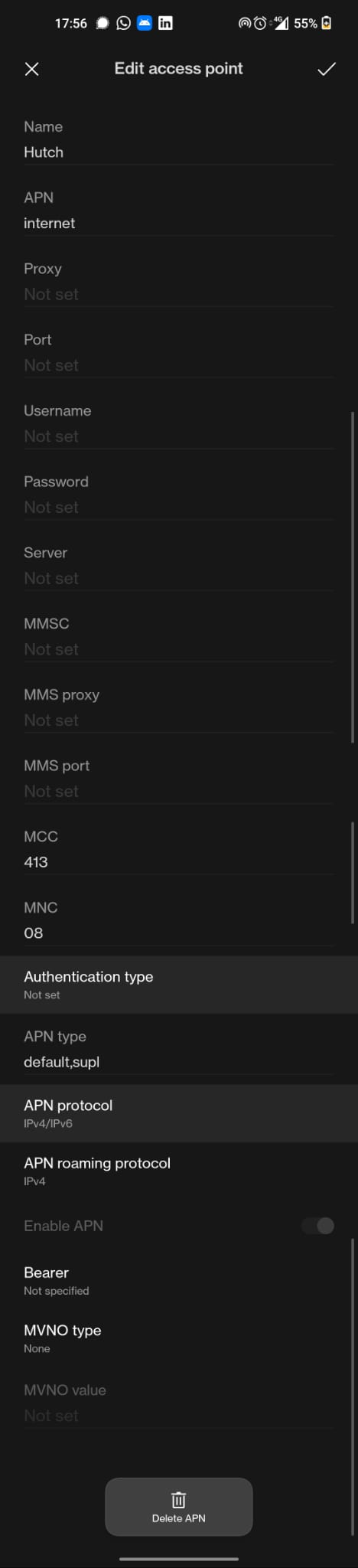

This is the 2 APN setting options that I get with the SIM card on my phone:
what is the AT+CGDCONT value for this provider.
if dont know try 0 and 2 as well
first time connection might take upto 30min. so wait for 30min before making next change. and also reboot after making a change
I’ve tried with both values (Waiting 30min in between & rebooting the IoT computer) without success.
Any other alternatives?? Could it be any Modem configurations?
what is the IPV setting for the network ?
I have no knowledge of this network provider so just throwing ideas out there. Generally network provider provides all this info and we just use them as it is.
